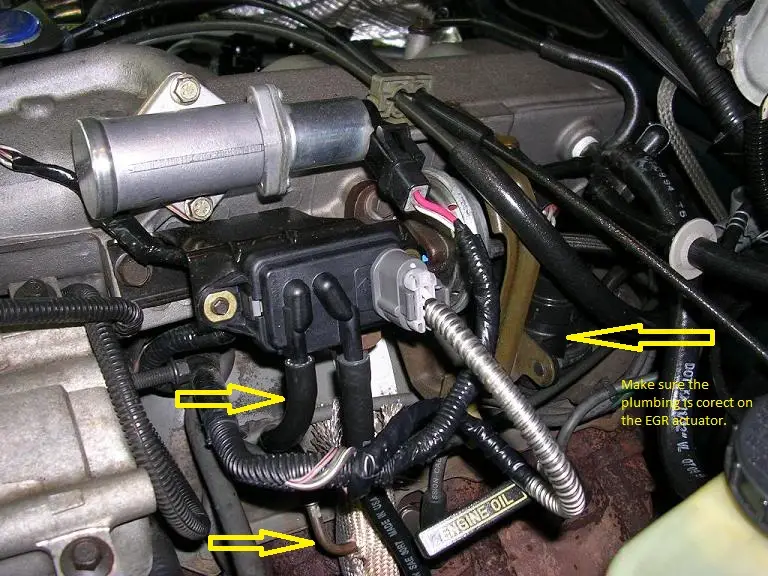

I ask because I suspect your EGR is stuck wide open.
Not usually a problem with the EGR valve itself, but with the valve that controls it.
Stuck up under here.
