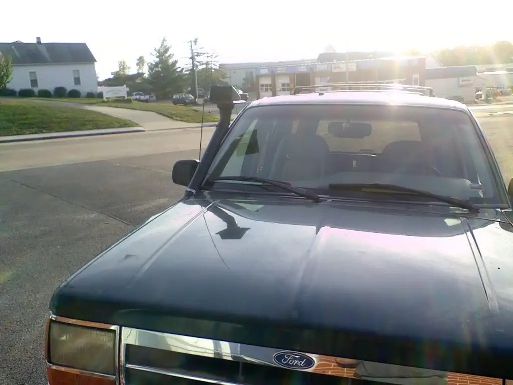

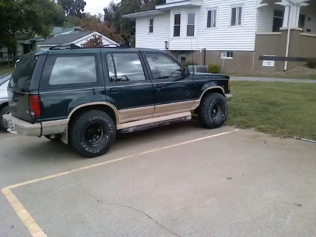

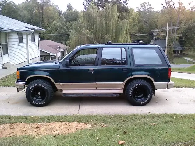

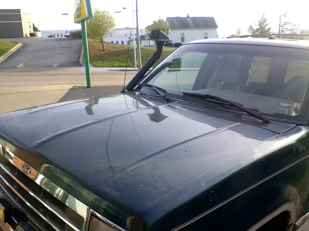

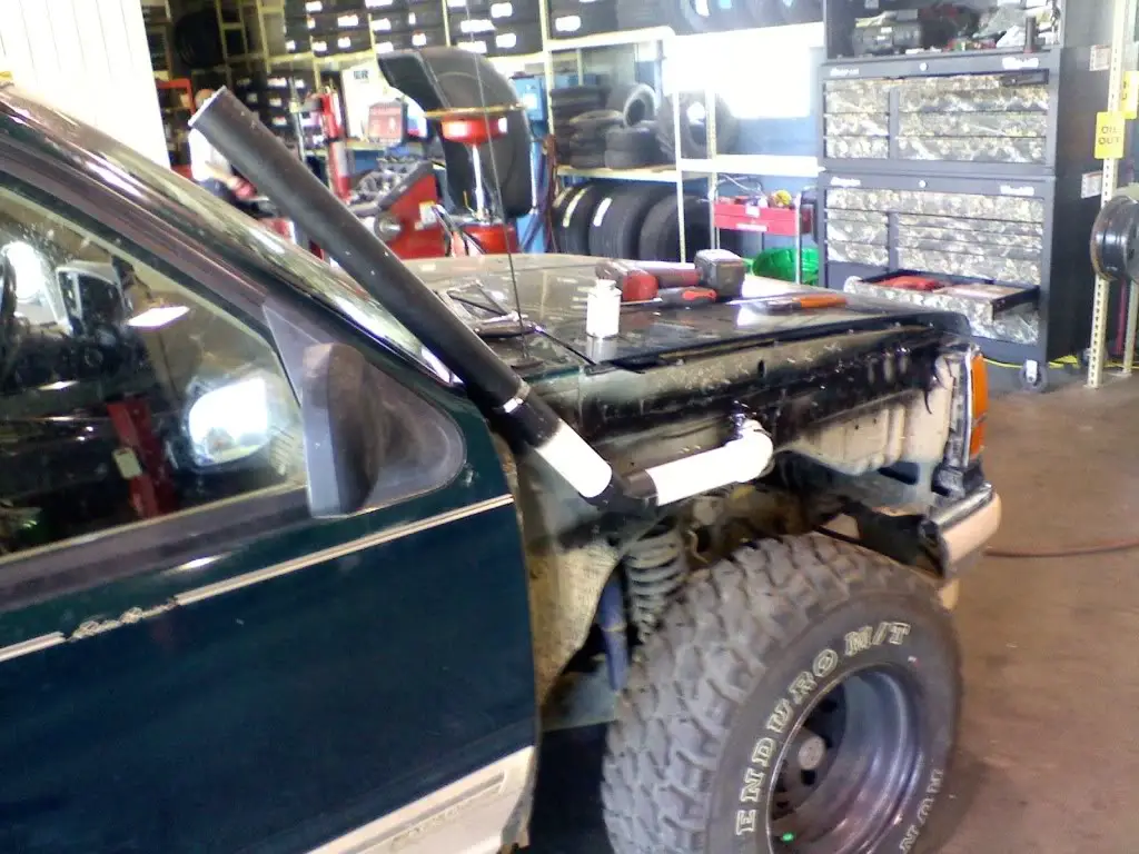

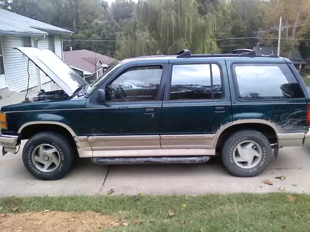

hello everyone this is my new project and first explorer so far all i have done is a set of wheels just steel ten holes painted black, with 31 1050 15 runway enduro mt's on them. i just recently completed my homeade snorkel everything on the snorkel is homeade and the whole thing cost about 24 bucks
here are some pics let me know what you guys think
It looks really good with those tires and wheels my friend!!!. (Good idea using pvc tubing)
good work man. nice rig. looks great.

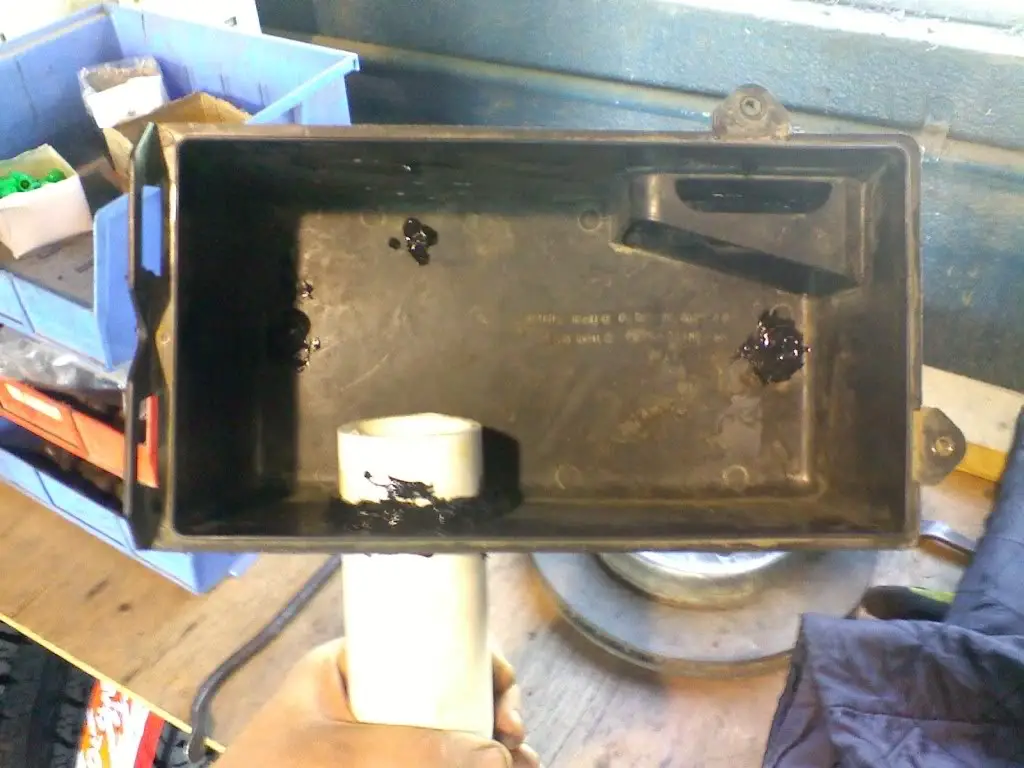

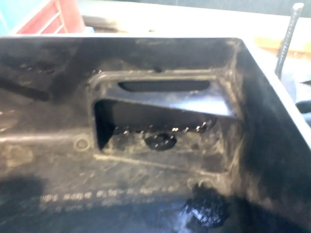

May I please ask how you hooked up your snorkel to the box? I had a snorkel on my Ranger, and got it decently sealed, but I didn't like how I had it put together.
yeah ill take some pics after work today so you can see it but i literally just ran the pvc pipe straight into the air box and used i decent amout of black rtv on both sides of the box where the pipe goes through
here it is all sealed up couldnt get good pics of the engine bay just yet ill have to remove my distribution box to get them but will probably have them posted tommorrow

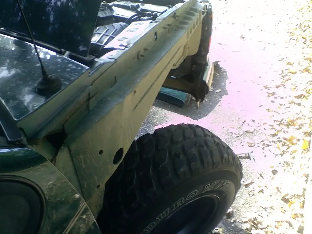

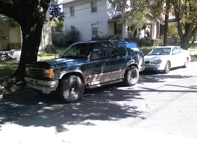

Did those rims and tires fit on without lifting the truck? I ve wanting to do the same with my 95 explorer sport but wasnt sure if that size tires would fit with the stock ride height and suspension.
The rims and tires look great on your ex!
awesome explorer! ive got a 92 xlt. These are way underrated on trails. I went wheeling in some places this past saturday ( oct. 16th 2010) and I ended up having to pull out a full size k5 blazer where I went through. I dont have a lift and ive only got 29 inch tires. Keep posting pics of your project. I will continue to watch!
the wheels and tires fit with some slight fender trimming on the backside of the front fender and fender well trimming also trimmed the bumper up some but that is stock height with ten inch wide wheels with a 3 and 1/2 backspacing
