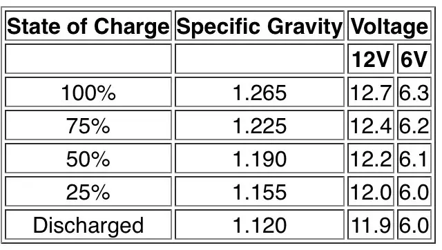

11 Volts is certainly a dead battery. I've seen problems with as much as 12.2 volts. As was stated Volts doesn't mean squat without current.
