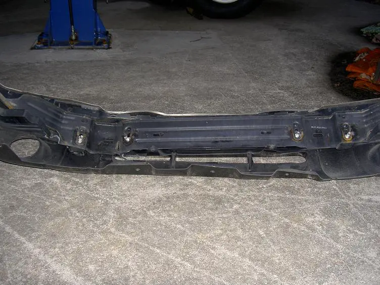

Does this help, I've got two old pictures of my 99's mangled bumper, the back side?
this is a 99 mountaineer bumper
The two center sections look alike, but the Mountaineer doesn't have the metal extending out beyond the frame bolts. If you only need the metal part, that might work for the Mountaineer. The bumper itself has most of the support built onto the back of it.
