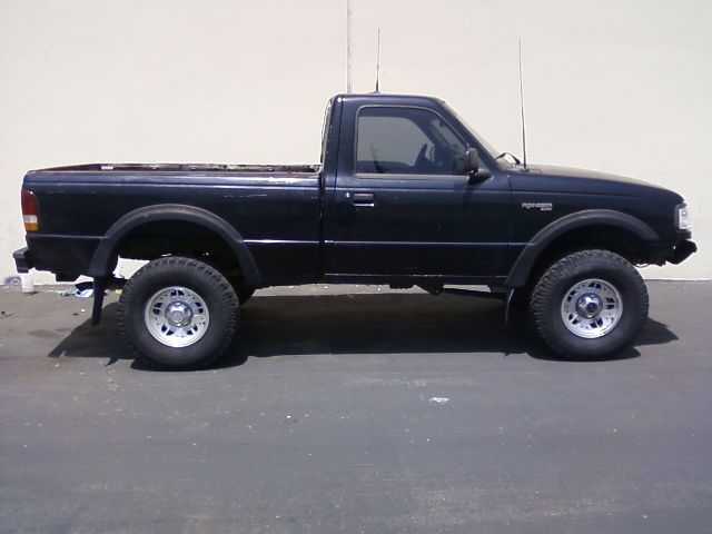

..Yes, It's my Ranger totally naked..This is pretty much how she looked when I first bought her..Well...Maybe a little more stock looking..
And? :confused:
..I was taking advantage of the moment as I needed a before picture..But I must admit, it's sexy...:D
...The after will probably be a 1/2 dozen or so years before the chopping begins..:hammer:
Pickups usually look better without a shell, but they are far more useful with a shell (depending on your use, of course.:p:)
