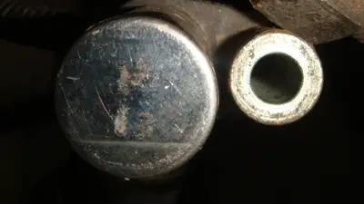

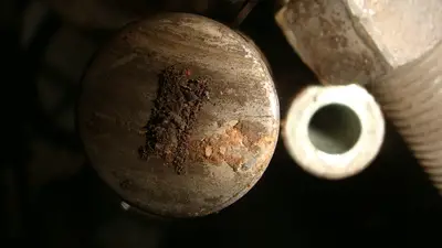

No guarantee to help, but lift the front tires off the ground and remove the small bolt on each sensor to clean the magnetic sensor heads. Spin each tire slowly while spraying brake cleaner with the tube in the sensor holes to clean
the slotted tone rings followed with compressed air. Seemed to slightly reduce my slow speed brake pull which turned
out to be a sticking caliper. For those interested this applies to RWD only, 4WD ABS sensors are integrated in the hubs.
