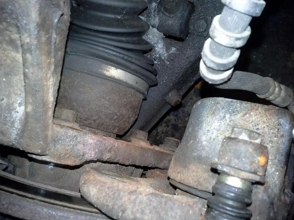

FINALLY got some time to mess around today.
I pulled the front driver side tire and immediately saw the problem.
I then went to the only place I thought would have hardware so late in the afternoon. They gave me this:
Not only is that bolt too short, but it's also SAE as opposed to Metric. The threads fit, but they are really tight.
It will work for now. Still doesn't solve my AWD problem.
Also, I'm tearing into the top of the engine tomorrow to see why I have quirky oil pressure and a MEAN tap/rattle sound. I'd actually be happy to have AWD and not running 100% At least then I could sell the damned thing pretty easily.
The entire reason I bought this rolling heap was to have a winter vehicle. Now I have 2 pieces of junk sitting in my driveway (the other POS is a 2000 Toyota Camry with 256K. Runs excellent but the body is falling apart around it.)
At least that control arm won't rust in a hurry.
