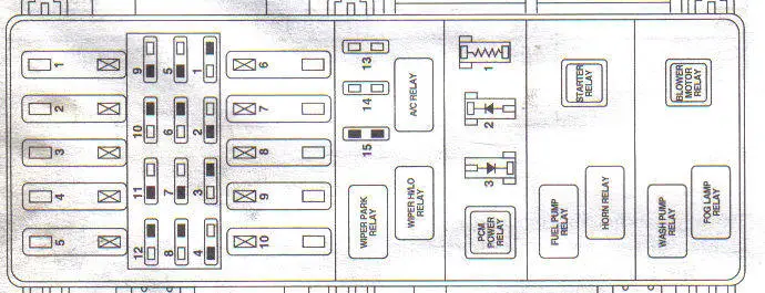

for about a half second, I think the injectors need at least 30 psi to spray, which goes right away if pump isn't running,Check your fuel pump relay, switch it with horn relay, see if it will start
