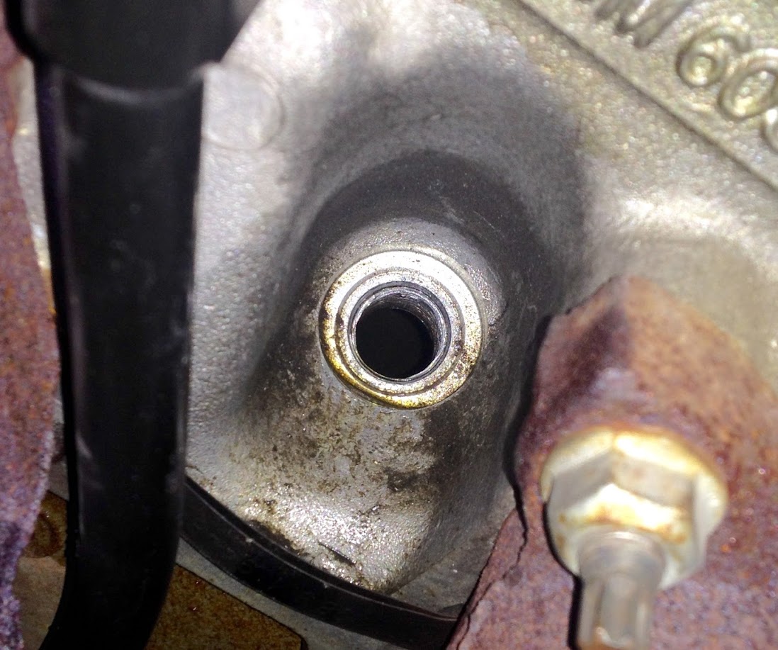

Thanks, koda. Hope it's something pretty simple like that. Also, here's a photo of one of the holes, if that helps further the diagnosis...

Most here use/recommend Motorcraft or Autolite spark plugs. I've always had good experiences with NKG plugs though. Fords are fussy about spark plugs and the don't do well with Bosch plugs for some reason. NKG's will probably be fine. In the brief time your photo was visible I'm not sure if I could actually see threads in your spark plug hole. How did the spark plug that came out of that hole feel coming out and look? Did the threads come out with the plug? That can happen if you don't use anti-seize on steel plugs in aluminum heads due to dissimilar metals electrolysis. If this is the case all is not lost. There's a thread repair system/tool called a Helicoil.

I hope you're right, Koda. Were you able to get a good look at that first photo I posted? You can just barely see the threads down in that hole if you zoom in... they don't look good to me, but it's hard to tell. :(
I agree, they threads don't look very good in that photo. If worst comes to worst you can always use the Helicoil spark plug thread repair kit. Helicoils work really well. I've used them for years to repair threads in aluminum. They're much stronger than the original threads. The kit comes with a drill bit, the Helicoil insert (which looks kinda like a stainless steel spring) and the installation tool.
