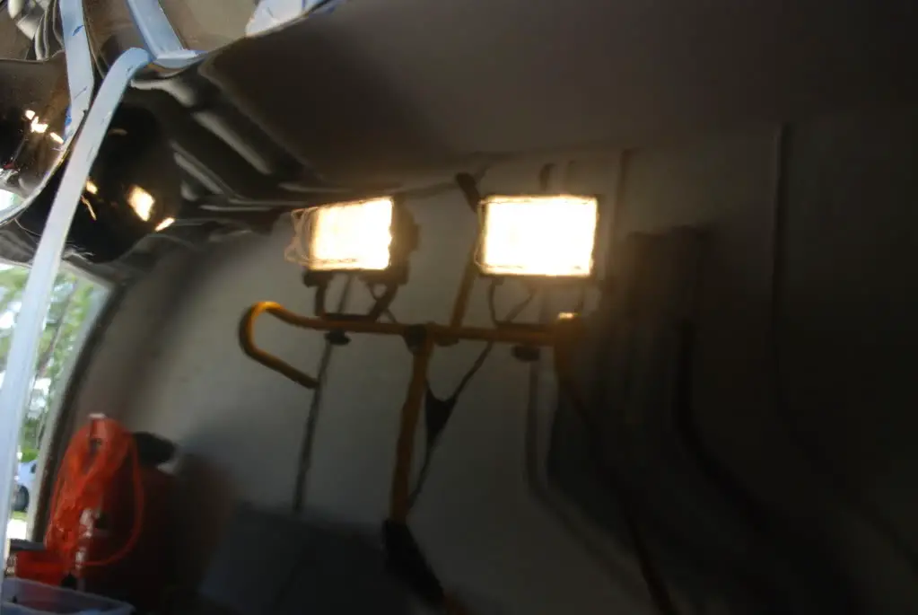

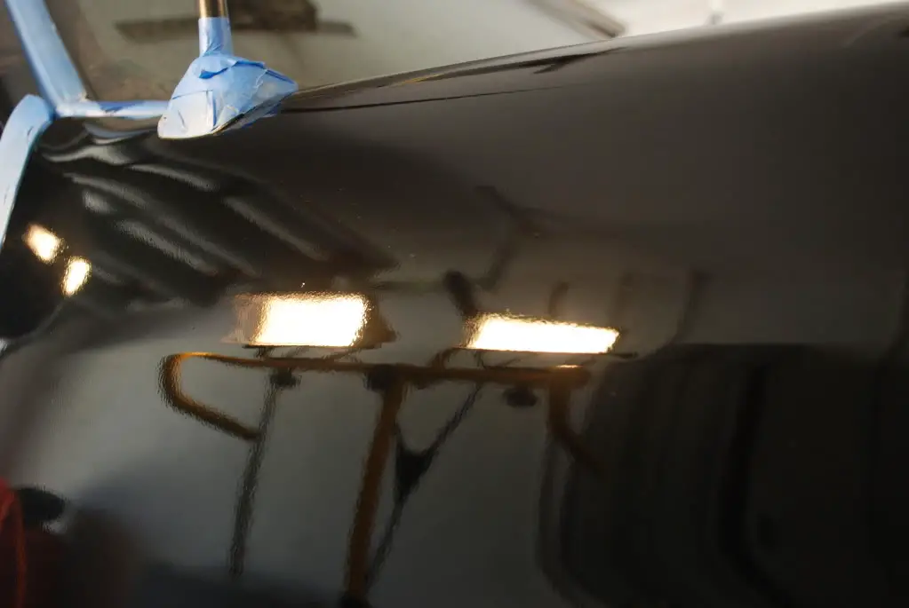

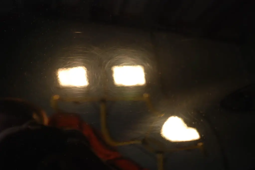

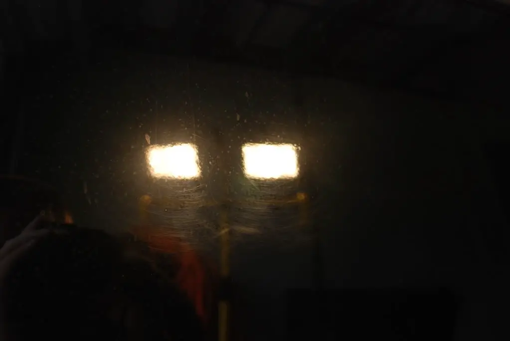

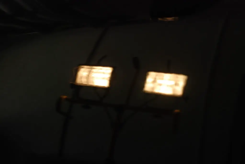

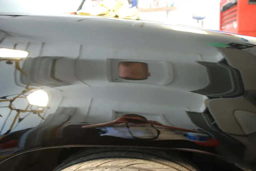

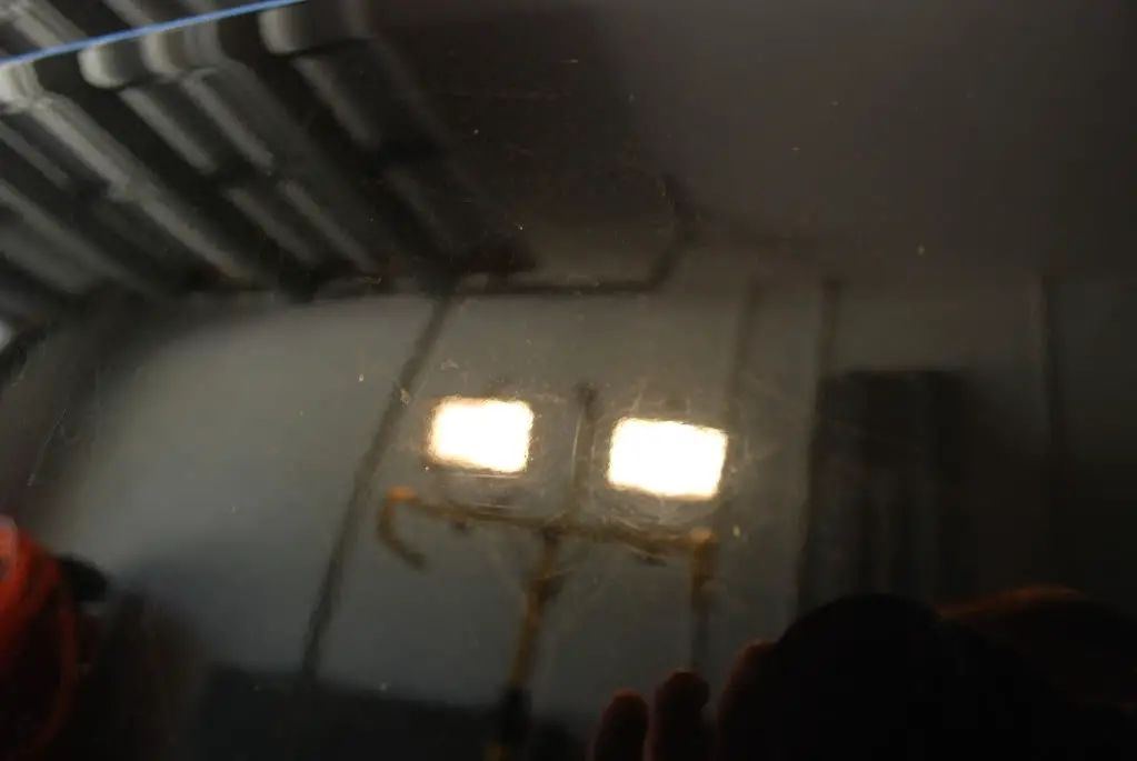

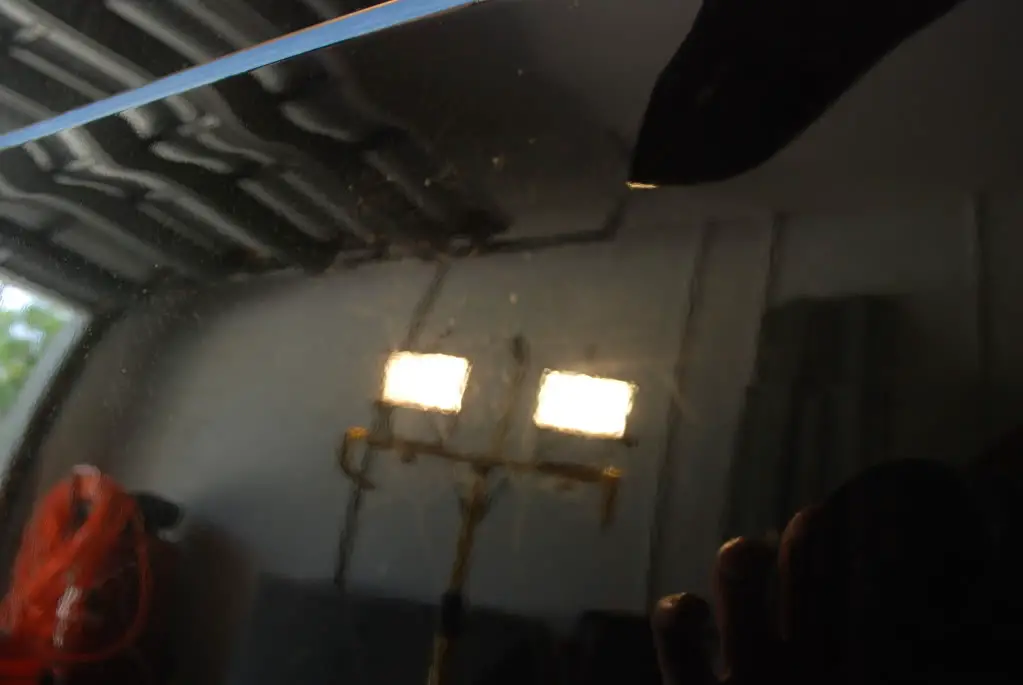

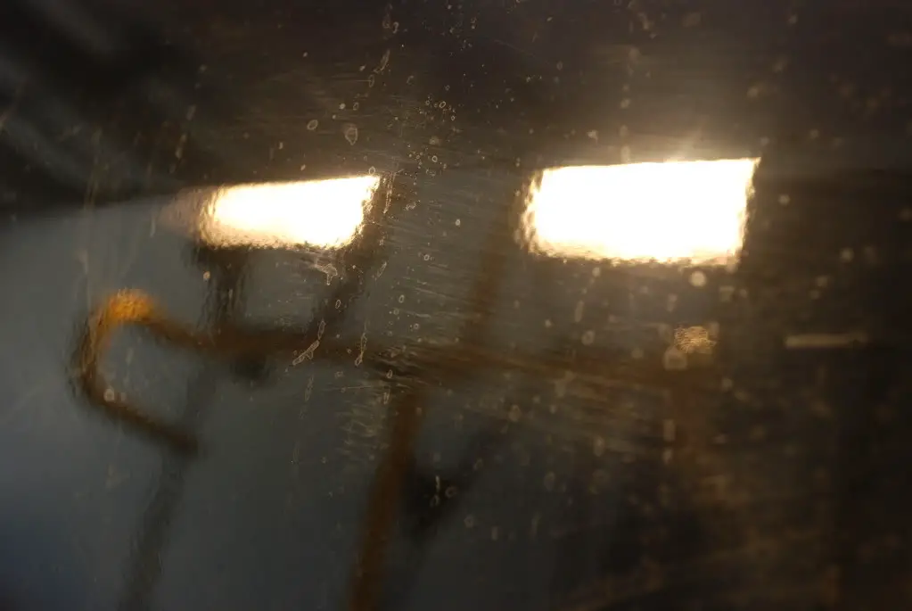

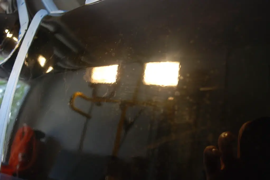

Here's a few teaser pics before I get back to work on the passenger side:
BEFORE:
AFTER:
I should have all the pictures of the finished product up tomorrow. Want it to be perfect so I'm taking my time.

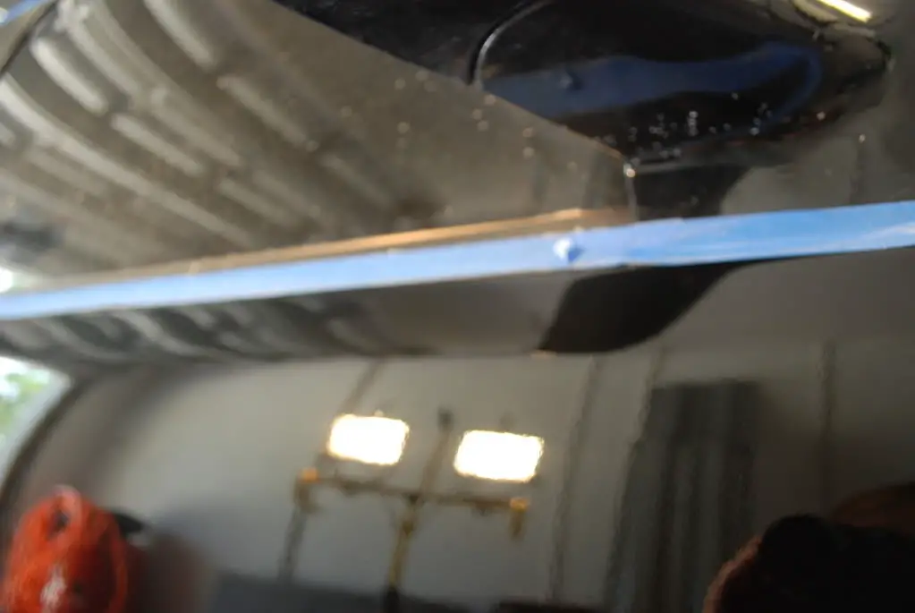

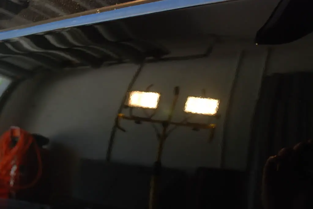

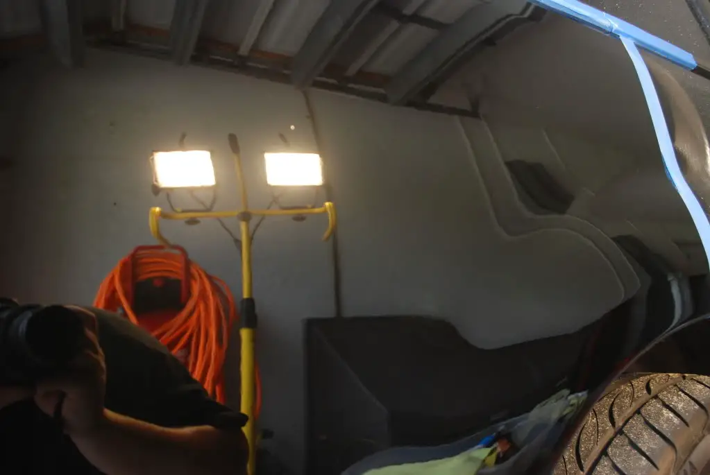

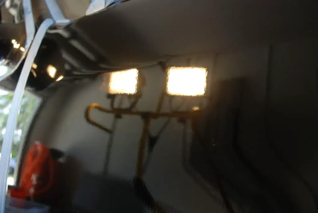

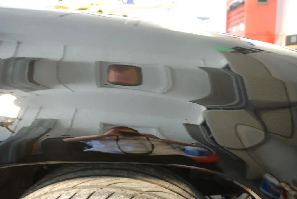

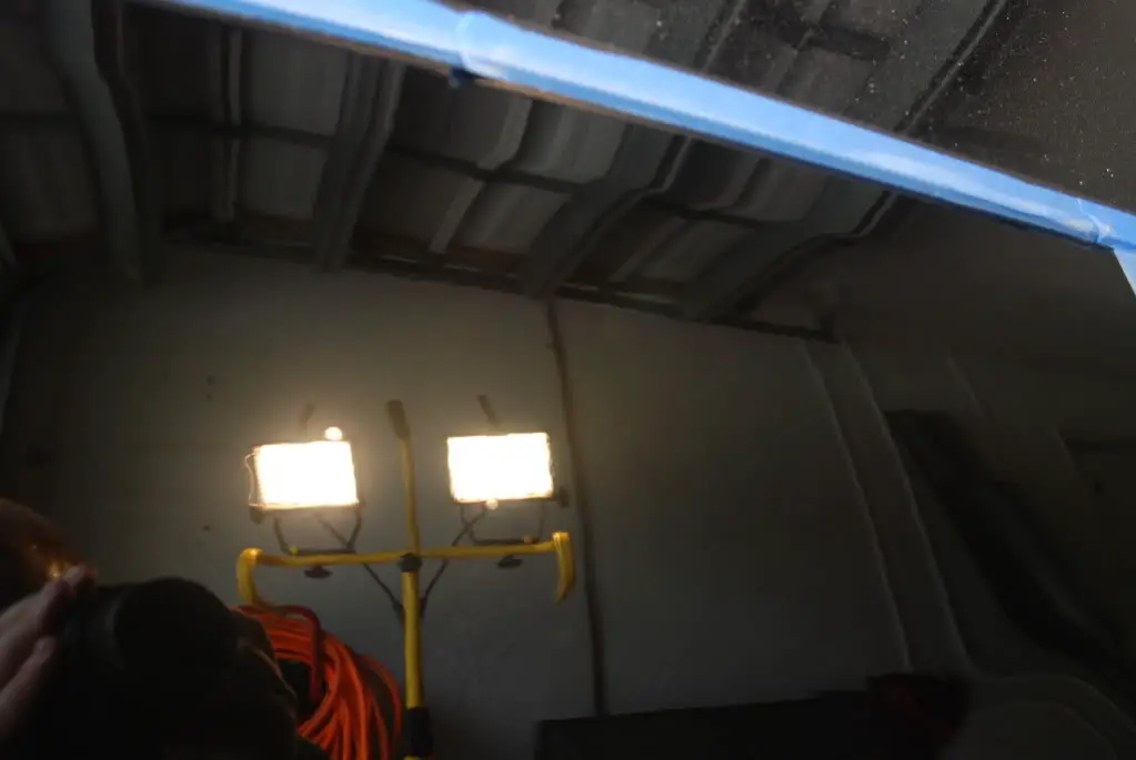

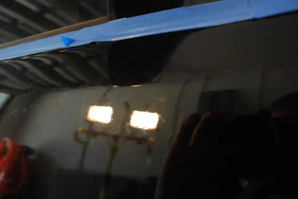

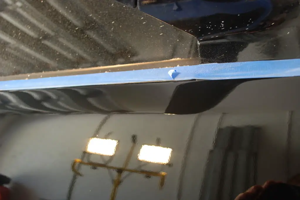

Moving on to the rest of the passenger side of the vehicle (before wax/sealant)
BEFORE:
AFTER:

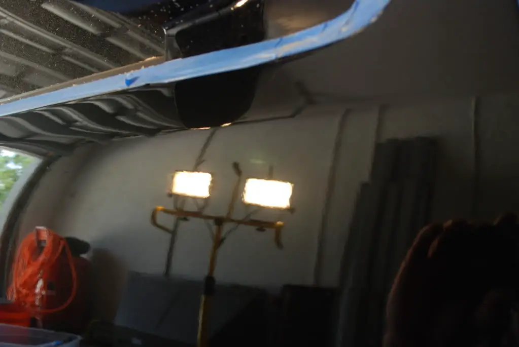

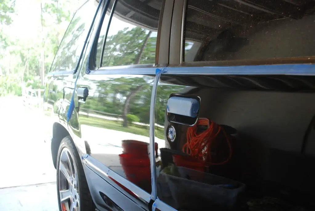

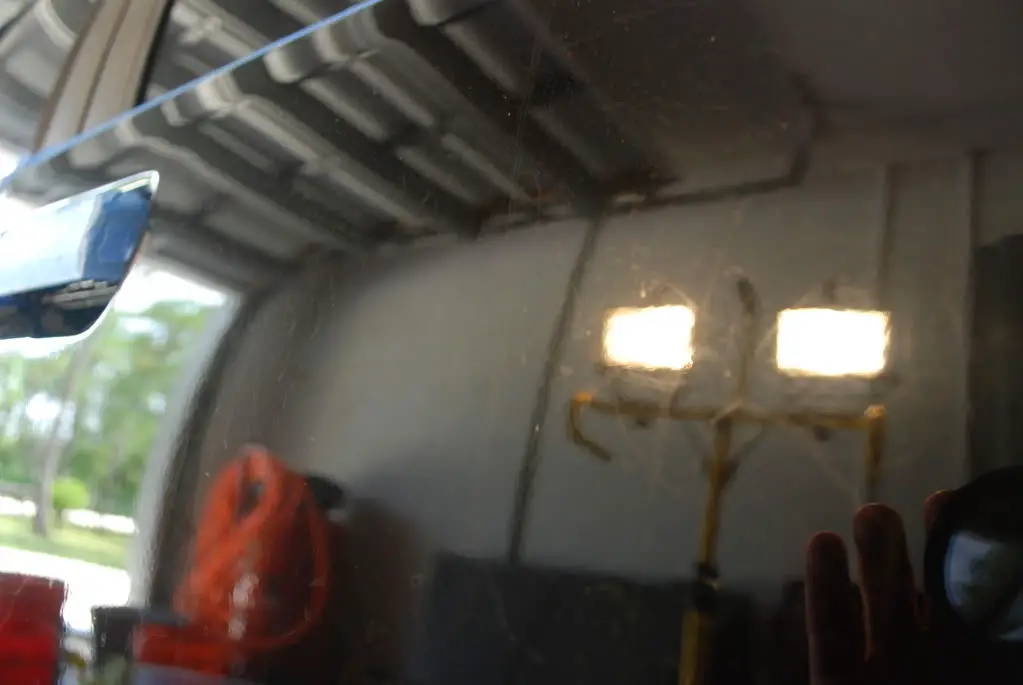

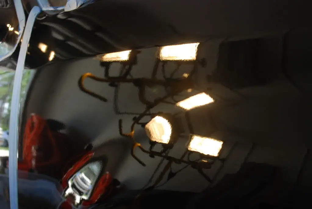

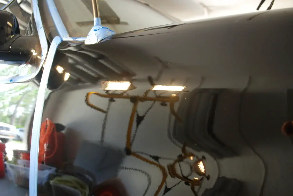

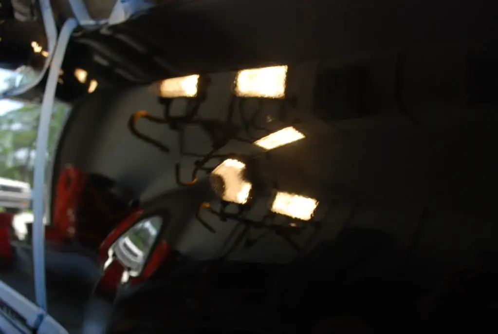

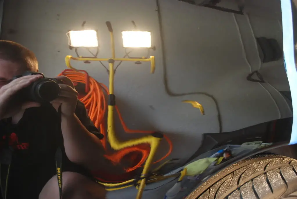

BEFORE:
AFTER:
I assume you are going to tell us what you are doing to make your truck look so fantastic?!
LOL! Thank you bro...here's the basic rundown of my process. Give or take a few steps:
I washed the truck using a 2 bucket method. (one bucket filled with soap and water, the other bucket filled with plain water and a grit guard at the bottom to separate the dirt from the water).
Next, I blew dry the car with a metro vac n blo (a vacuum that doubles as a blower).
Next I taped off the entire truck and made sure there was no dirt, and did the 'newspaper bag trick'. (ran my hand in a newspaper bag down each panel making sure there were no contaminants and dirt in the paint) which there wasn't because I just had it painted a few months back.
Next, I hit the truck with some m105 polish on a wool pad with a rotary with 2 passes, followed buy some m205 on a lake country blue pad with a dual action polisher and then wiped down/checked my work with some isopropyl 92 percent alcohol with microfibers.
That's the gist of what I did. I'm sure I left a couple steps out.

it has a brand new paint job and the body shop cut me such a good deal because i agreed to do the finishing work (polishing). So all wetsanding, etc was done prior and this is fresh/soft paint, so my polishes finished down real nice for me. :)

souveran wax and poorboys ex-p sealant. always treated me well over the years. in between, i stick a coat of danase wet glaze to get a shine like this:
