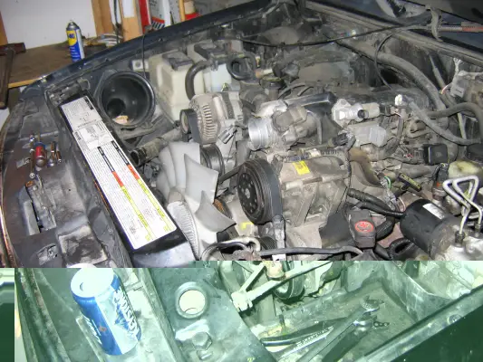

At the beggining, notice the leaves in the airbox and 130K worth of dirt:
I started by removing the 95 engine (obviously)

When I drained the oil I found more coolant then oil. A tear down of the 95 block is coming, we shall see how far the damage goes..
Bare bay:
Engine out:
95 block stripped of intake, accessories:
