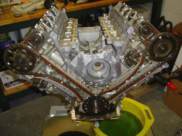

correct tensioner?
Is it possible that you have a rear tensioner installed in the front? The front tensioner is about 1/4 inch longer than the rear tensioner from the end of the piston to the face of the housing that seats against the head.
Did you install a thick compression ring reducing the effective length of the housing?
Is the oil port in the head blocked with some obstruction?
With the engine running the piston should be extended and the amount of the extension should be fairly constant. Something is causing the guide to force the piston to its retracted position. That means that at some instant the chain on the slack side is becoming taught. Are you certain that your firing order is correct?
1-4-2-5-3-6
Remember that on the ignition coil 6 is between 4 and 5.
