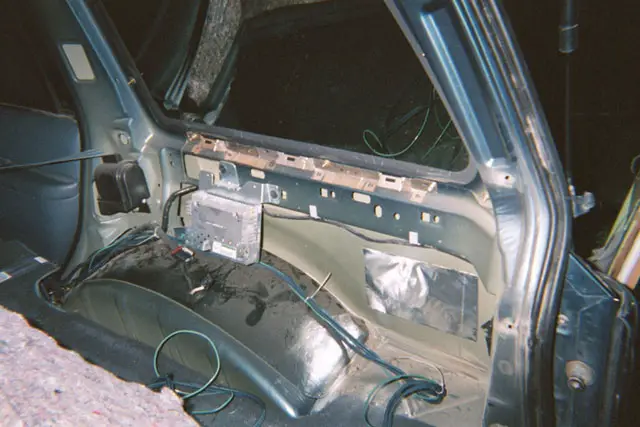

I want to make sure i order the right harness, i have the non-JBL stereo(AM-FM + Cassette, with auto-set button), but amplified like this
I saw a write up with no pictures(moved or deleted) and it mentioned something about black plugs, and needing the 70-5600 Metra kit(this is what i saw on the back of my radio)
Sorry for hi-jacking the thread and if i'm being annoying, but i don't want to screw up the sound system.
If you need a picture of the radio i can get one.
