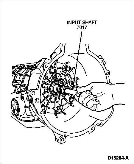

ok so here is a dumb female question lol
where do i find this shaft? everything was tied in when i got the box and didnt see anything fll out when i undid it all
Oil pressure can be checked with a pressure gauge. The shaft slides into the front of the trans thru the middle of the pump, and must be installed before the torque converter is installed and it only goes in correctly one way.
