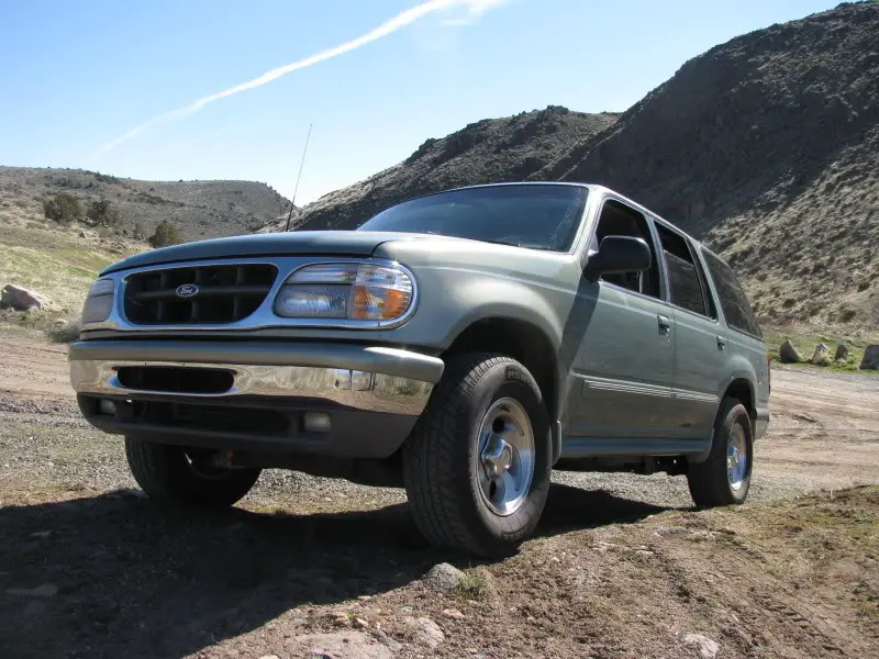

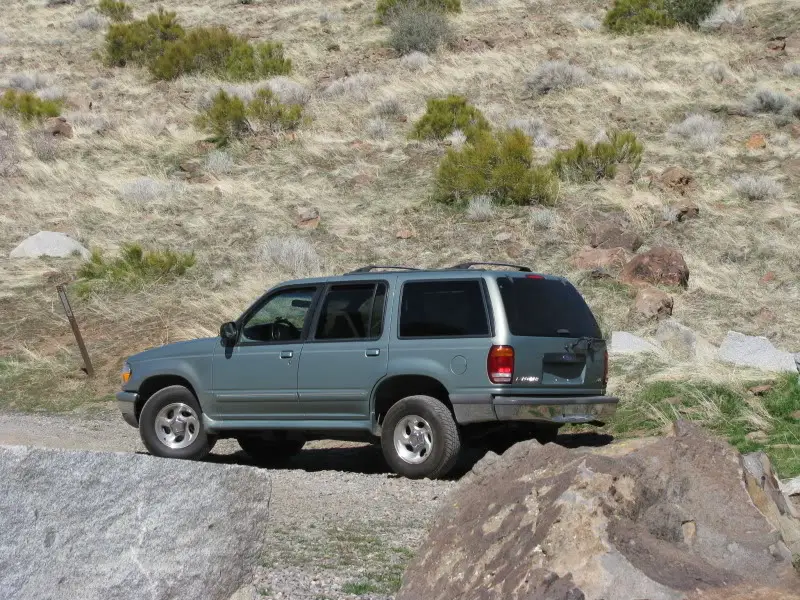

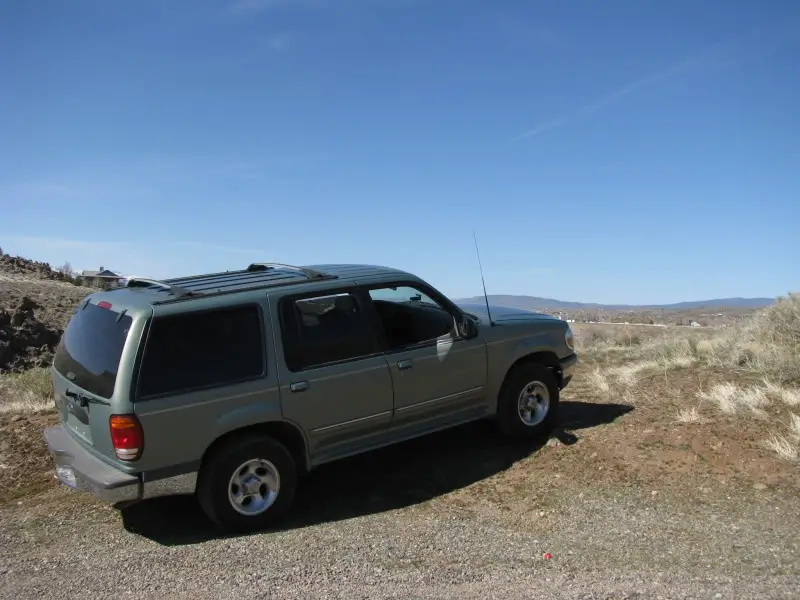

Hey Jon. I was wondering where you'd gone. I've had 2 explorers since we used to talk. I've had a total of 22 cars since we have talked. Lol. I flip them, pretty much. I bought the current Explorer to flip but Honestly I think it's a keeper. It's a 98 XLT 4X4 with 99K miles. Super clean. Only thing wrong is the heater. I got it for $2,600..
How have you been? Where's the Mounty?
Here's the current:
