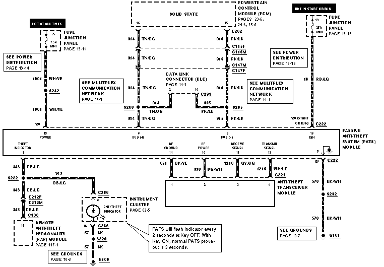

The wiring for the PATS module goes up to the steering column. I'll see if I can get a diagram for you so you can check it. In the "Under The Hood" secton under the PATS thread I posted what wire colors were what, so you can look under there and see.
Did you have a remote start system at any time?
The Transceiver Module is located in the steering column and gets the code from the key. The wires from it go to the PATS Module, which appears to be somewhere behind the passenger airbag. It then connects to the PCM.
you can try testing those wires but in the end you may have to bring it somewhere to be checked out. Hunting down all the different wires is going to be a ***** and with the right tool, they'll be able to track down exactly what the problem is (or at least, should be able to)

When I went through the trouble shooting list, I am down to two possible problems, a bad PATS module, or a wiring problem between the PATS and the PCM. My only thought is maybe something is intermittent that is affected by vibration..
