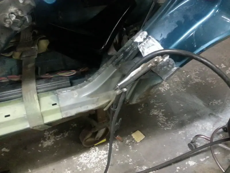

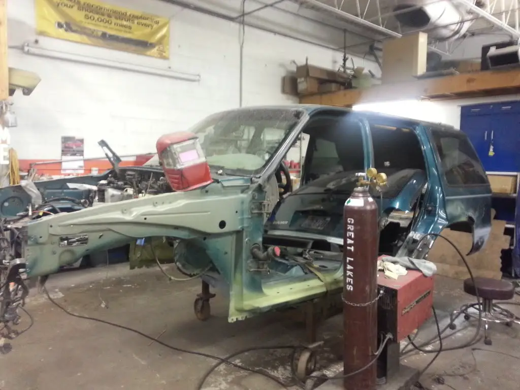

Here are a few shots to show the progress and a bit of carnage:

It is pretty scary just how much you can't see. I thought I had all the rust pretty well documented. Once they started tearing into it though, I realized just how rough it really was. Despite the cost, it makes me glad I chose to have a shop that specializes in restorations do the body work. I'm horrible at it, haha. It'll be nice to have it back to pretty much factory condition, and making sure that I keep it clean, keep it coated in and out with rust prevention stuff, and using salt-x during the winter should keep future rust repairs to a minimum. I have no illusion that rust will never return though, but as long as I can fix it before it starts rotting through, the body should be able to last me til the apocalypse. And then it becomes a zombie hunter truck :D

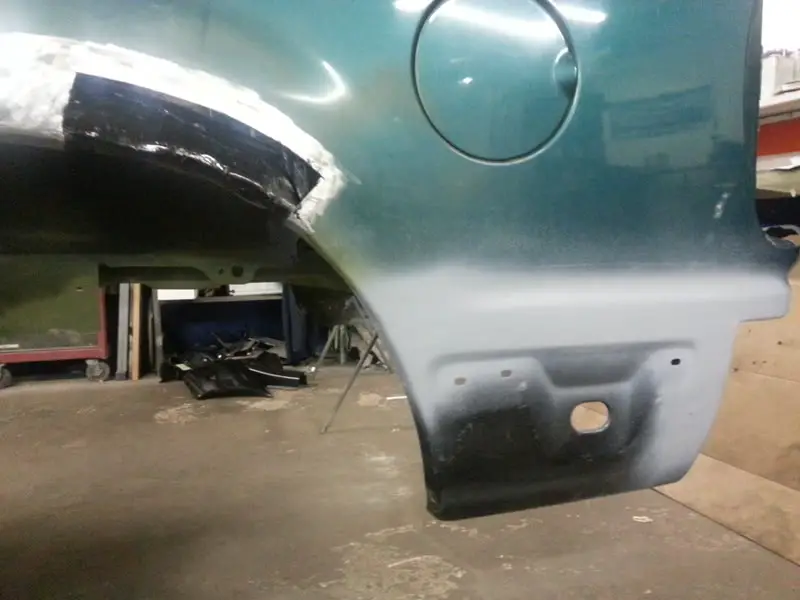

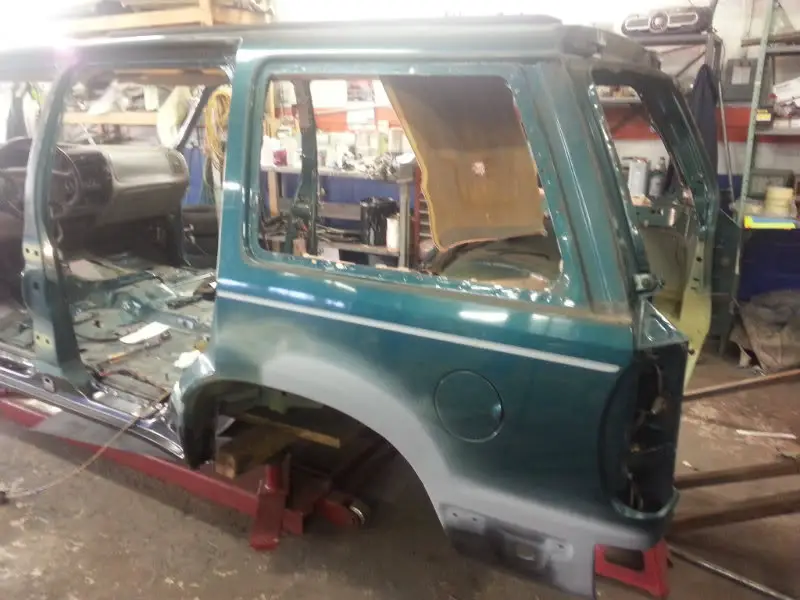

More progress shots! I'm amazed and impressed by how fast and how good their body guy is. He's also the paint guy, and damn good at that too. I feel very confident that I brought my baby to the best guys for the job. Heck, he's been doing paint and bodywork for longer than I've been alive. He says that all the bodywork should be done by either the end of this week or early next week, depending on if he finds any other tricky hidden spots. Excuse the cell phone shots; I really need to start carrying my camera in my truck.

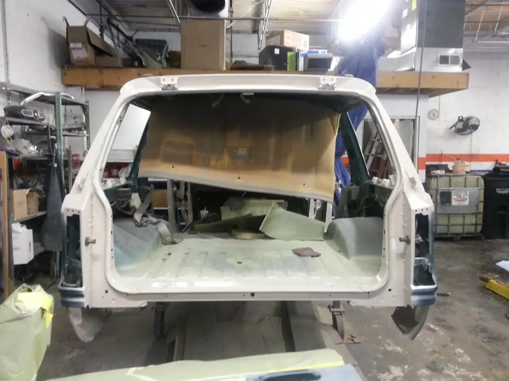

And the glass also got pulled today. No rust on the glass lips! I'm so very much relieved about that. Every single one is in perfect shape. I do need a new front windshield though, as there are a few nicks from where a semi was throwing debris as it almost ran into me head on. I'd trade a new windshield for my life any day though.

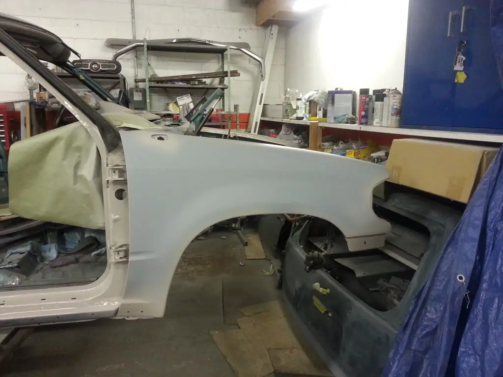

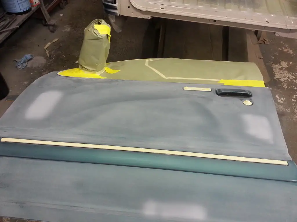

Fenders and doors getting prepped:

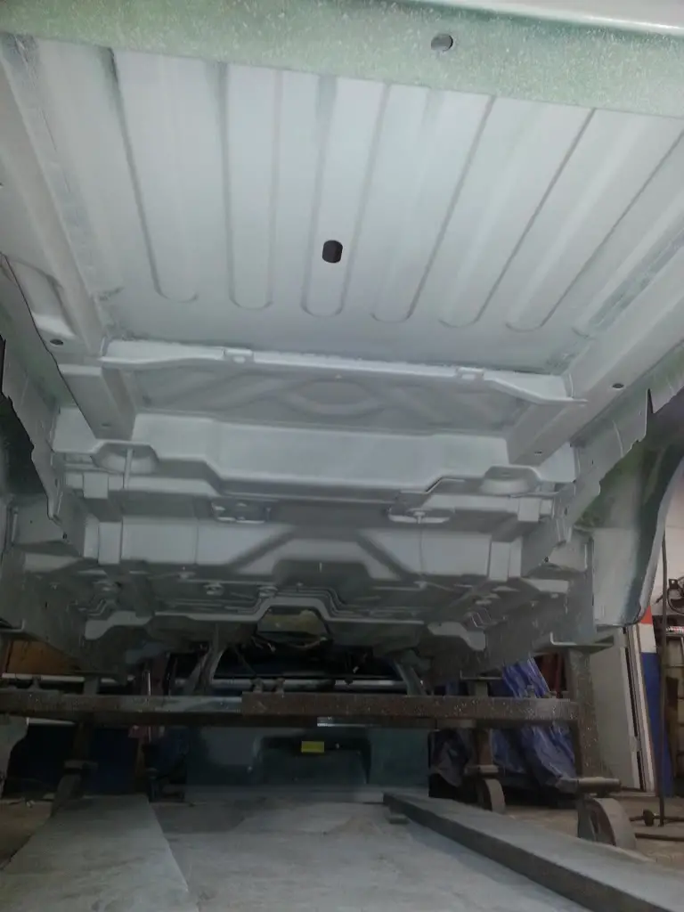

Underbody POR15 and bedlining all done! The color is nearly a perfect match to the base coat, minus the gloss. Ignore the fact that it looks grey in the picture, and I'll post another picture with a real camera:
