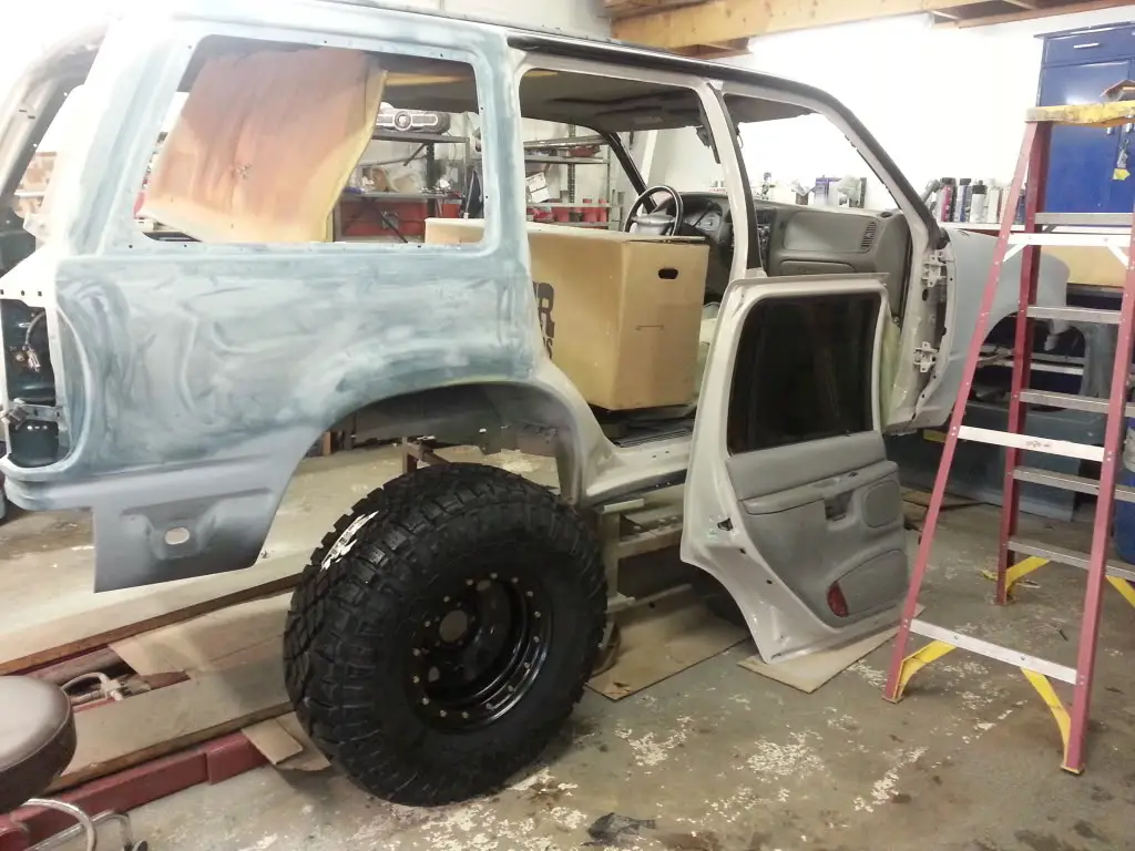

A quick update for today:
I picked up the new tire and had it mounted on my new wheels today. Just the one for now, so they can check clearances once the frame and body are mated again. The 4 doors are now done as far as the inside goes. The exterior paint won't be done until all the work on the liftgate and hood are done and the vehicle is whole again, so that way there won't be any small gaps with the digital pattern due to unsupported body weight.
How's this thing supposed to roll with no axle?

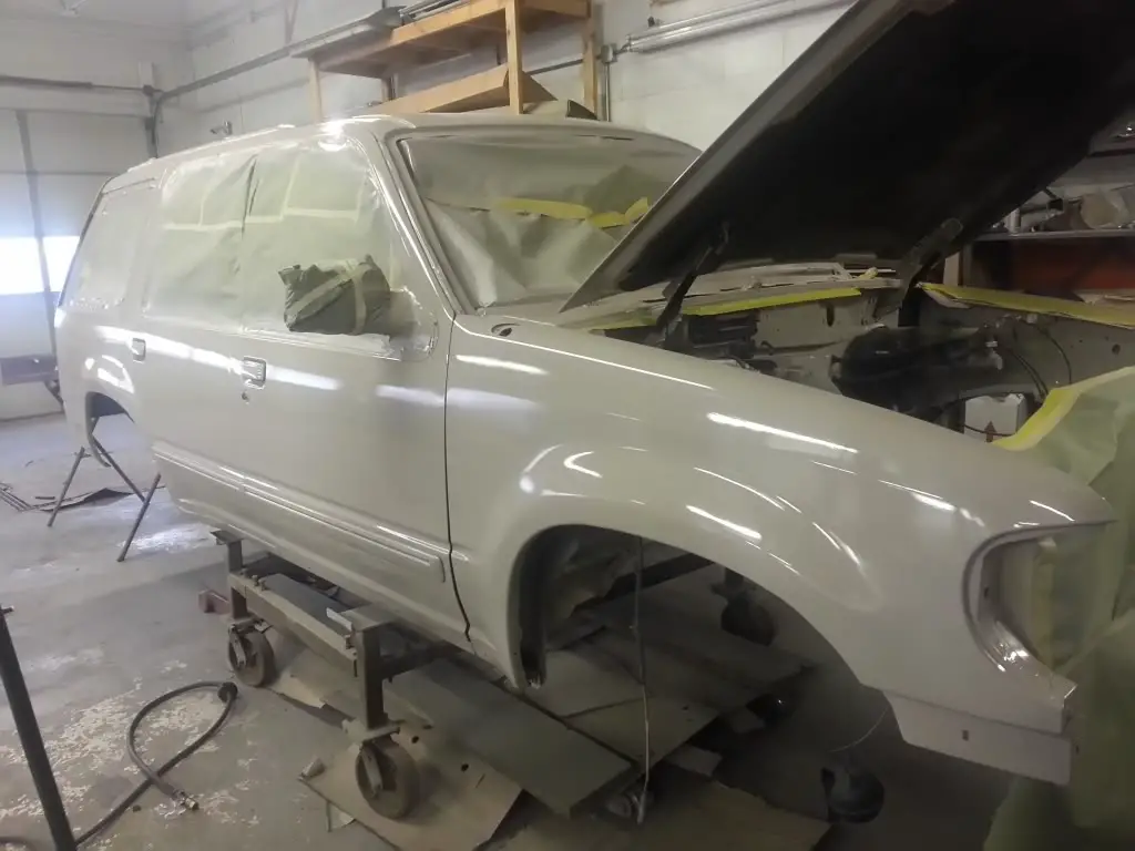

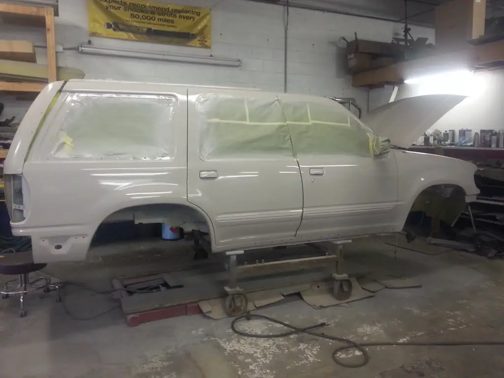

Oh man oh man oh man oh man oh man oh man oh man oh man oh man oh man oh man oh man! Super excited today!
I'm gonna be a small tease and tell you all that the pattern work has started on the liftgate, but I don't wanna post any pictures of that until it's all done :D
As you can see, they put clear over the base, but all the pattern work so far is just the flat coat until it's done. I'm actually very glad I decided not to go flat, because it doesn't look good, definitely not as good as I thought it would. So kudos to them for changing my mind.
Don't worry about the panel gaps or anything yet either. They just fit them up for the base coat, everything will be perfect before the pattern work starts, they just need to get it on the frame first.

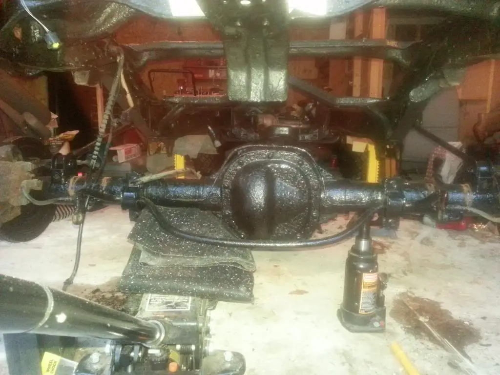

Leaf springs are off!
Gonna take the Superlift leaf springs and sway bar links to work tomorrow to press the bushings in. It's kind of a PITA to try and hold a leaf spring in place and squeeze a MASSIVE 6" vise on it at the same time. So I'll just grab a coworker inappropriately and have him help me use the hydraulic press.
As far as the rear goes, the only difficulty I'm encountering is the upper shackle bushings, the ones pressed into the frame. I used a ball joint press to remove the sleeve, but the rubber is still super tight in there. I'm gonna try a trick my buddy told me about. He said to get a large drill bit and start digging into the rubber, and as it spins it will start slicing it all around and basically shred all the rubber and barely touch anything else. Then just hit it up with a flapper disk and press the new bushings in.
I just gotta get a few new nuts and bolts, then the new springs, sway bar links, and the u-bolt/shock skid plates I bought from Brian1 will all be installed. I also want to see if any bushings I have will fit the two "track bars" the 5.0s have. At least I think only the 5.0 models have those, not 100% sure. Might have to get replacement Ford bars. Then swing the chassis around and start on the front of the lift! Hopefully, assuming no catastrophes, the suspension will be all done by Sunday.
I have a question for you guys though. I have a new set of stock (chinese dorman, yuck) shackles, but I'm wondering if I'm better off just cutting the set of :us:Warrior lift shackles I have down to stock height. The stock ones are so weak compared to the warriors, but I don't really want the extra 1-2" of lift. That's too much with a 4" Superlift and a 3" bodylift. I just got my 33s, I don't want them to be too small already!
