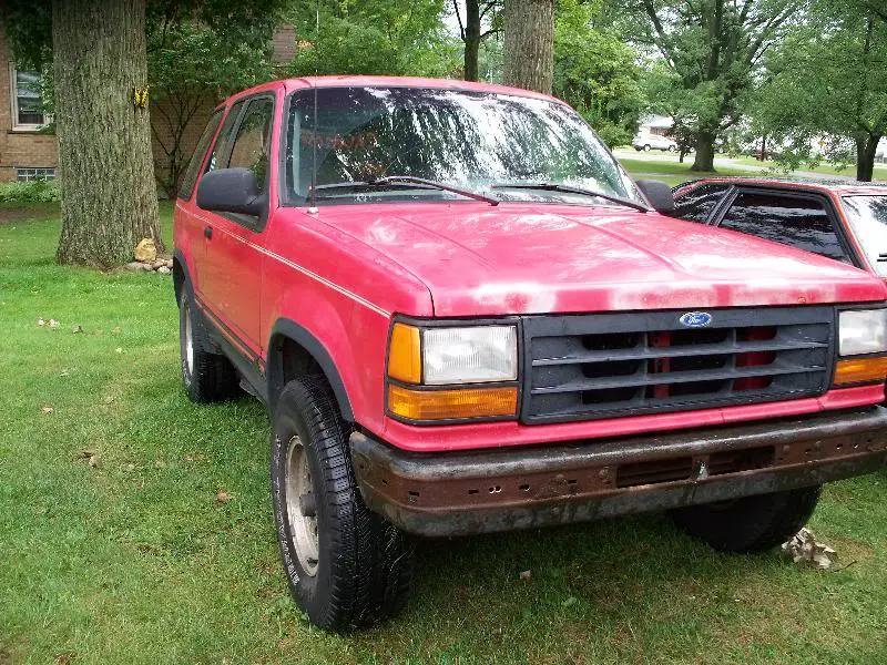

Well I started off getting this gem for only $450 and needed a clutch, rear main seal, and new vavle cover gaskets; and it even came with the clutch kit.
To begin with, its a 1992 4.0L obviously and is a stick shift and what I believe is 195,000 miles could be 100k less or 100k more, who knows; only thing I know is that it doesn't have the typical lifter tick.
Costs to get it where it is:
$450 explorer
$60 Flywheel
$65 Slave cylinder w/ throw out bearing
$14 Rear main seal
Labor FREE
+_________
$589 this far for a running and driving explorer that don't look too bad.

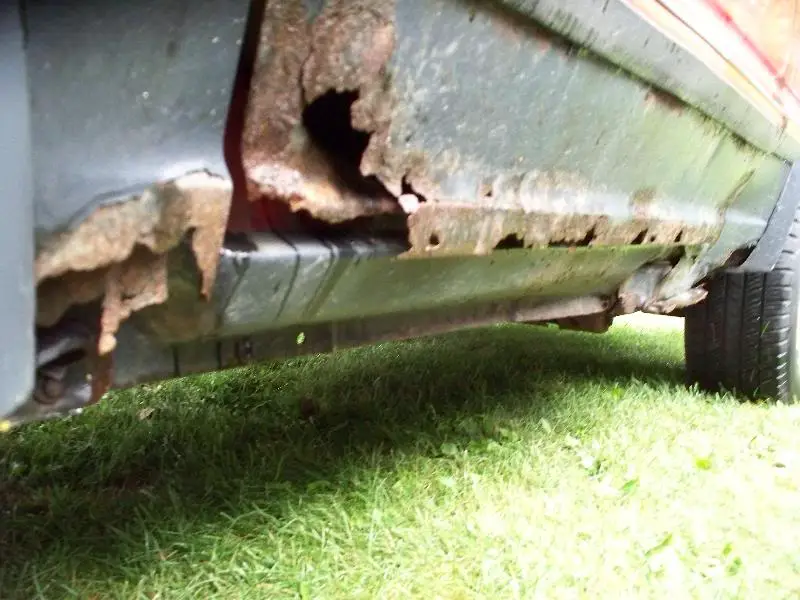

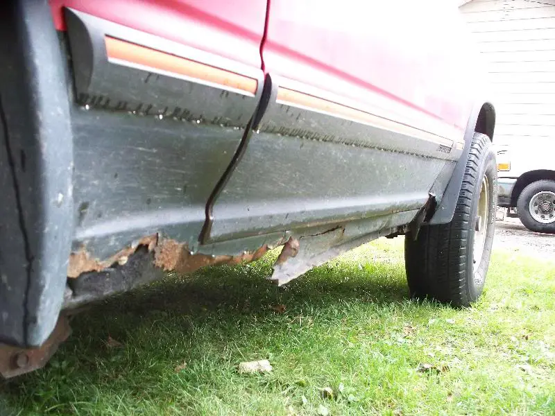

-Rockers are gone so I will be cutting them flush with the bottom of the door and weld in 2x2x0.125 or 2x3x0.125

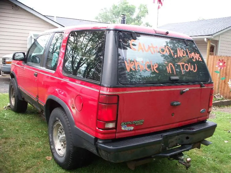

Don't mind the writing, I had to tow bar it home and I forgot the lights stupid me :rolleyes:

I would do .188 wall tubing minimum under the doors. I also would not do them flush with the bottom of the door. Hang it out a bit to help protect the doors.

Since you're gonna be cutting rocker off anyway, go a bit higher and get the bottom edge of the door too. Its easy and gives alot of extra clearance. Check out the last page or two of my rebuild thread.
