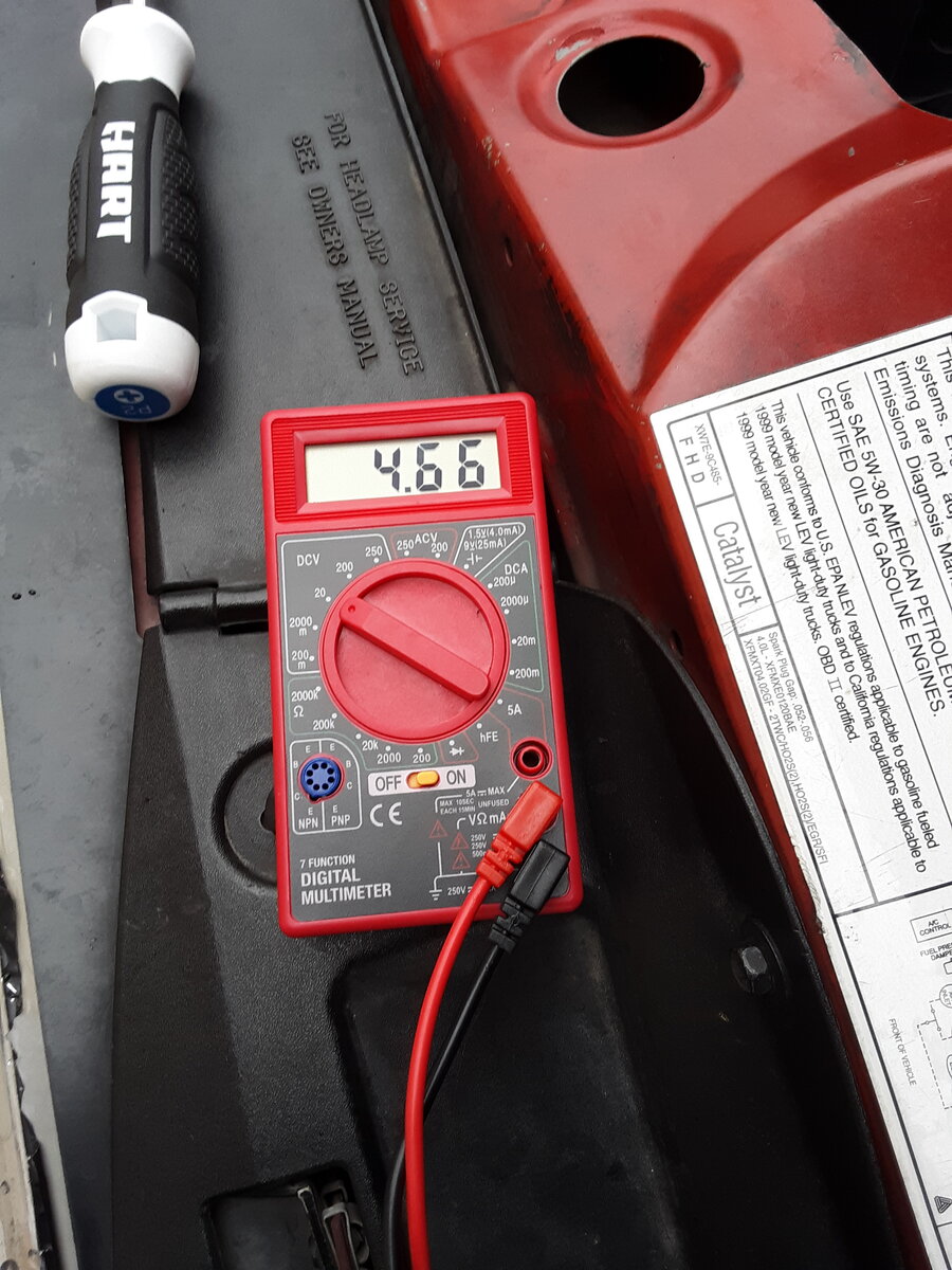

Hello guys I have a 99 explorer 4.0 SOHC that is having some weird idle issues it idles way too low like around 400 to 500 RPM and I have replaced the IAC Valve DPFE Sensor TPS sensor and cleaned the MAF I've also replaced the fuel pump and fuel filter along with the intake manifold gaskets
