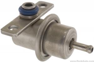

You've tried starting fluid with no luck. Your spark plugs are wet with fuel from cranking the starter but not firing. That indicates the injectors are pulsing. The fact that the engine died while the vehicle was driving is significant. Maybe the air/fuel ratio is too rich. Try disconnecting the vacuum hose from the fuel pressure damper on the fuel rail and see if fuel is present.
Sometimes the diaphragm in the damper will rupture allowing fuel to get sucked into the intake manifold.

No fuel out of the damper hose. No bueno. This truck is an anomaly. I will either send it hurling from a tall cliff or leave it alone for a while, of the two I think just leave it alone.....however, I feel the timing is just thrown off by the cps or CPU. But like I said, break time! (Months) be back when I DO have an answer.
