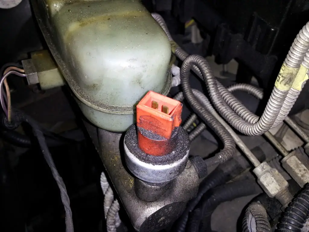

Cool I'll try to search for it! lol I was referring to Speed Control. And I just realized where my problem may be...
Yep, That could be it!...this is the new style switch, so I would try cleaning it before buying a new one...Was it not connected?
Really? I thought the Orange switch is the old catch-fiery one, and the black one was the new style? :confused:
PS: And yes, it was connected.

I went and looked at mine...My Bad!...lol. Yeah, get rid of that one!

Yeah, I don't think I even have the jumper harness either. Going to clean up the switch, but I don't think I am re-connecting the harness at this time until I get those parts. My truck is sitting in my garage right now, YIKES! lol

I'd try it...can't see what it could hurt. Even if everything checks out okay, I would still replace the switch. It probably won't catch fire if you clean all the gunk off it. I used throttle body cleaner on mine.

This is true. Plus I think the main problem with these comes from internal failure/corrosion rather than outer gunk. Still nice to have it sitting pretty. Going to do the diagnostic tonight after I put a window regulator and motor in lol
