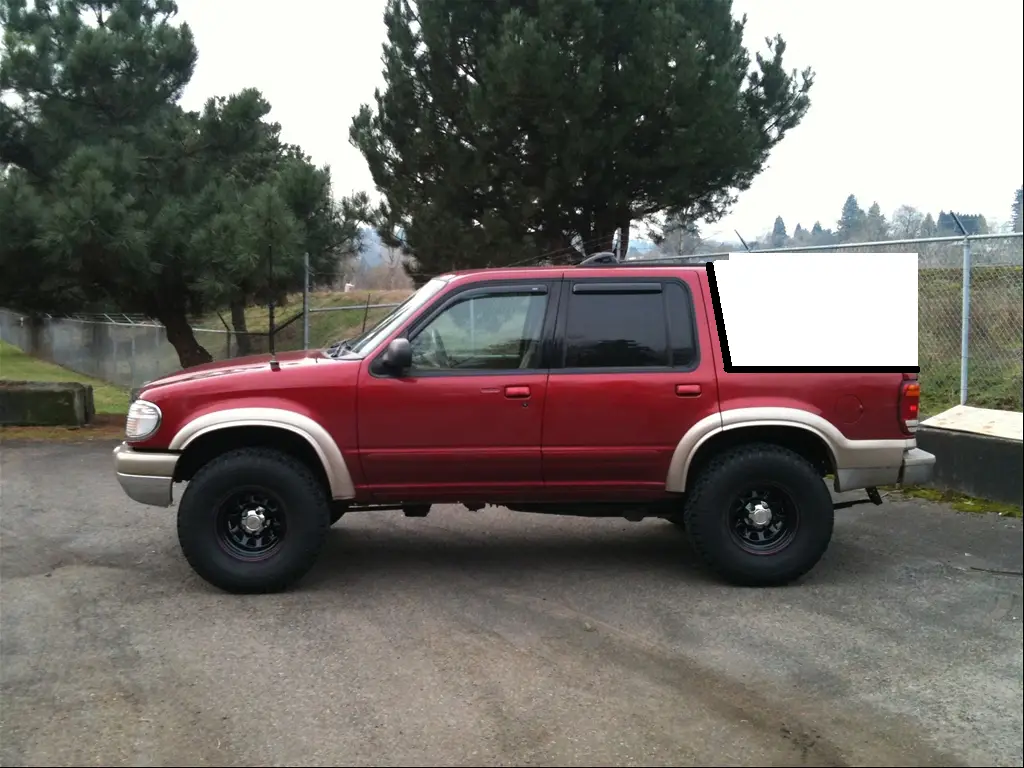

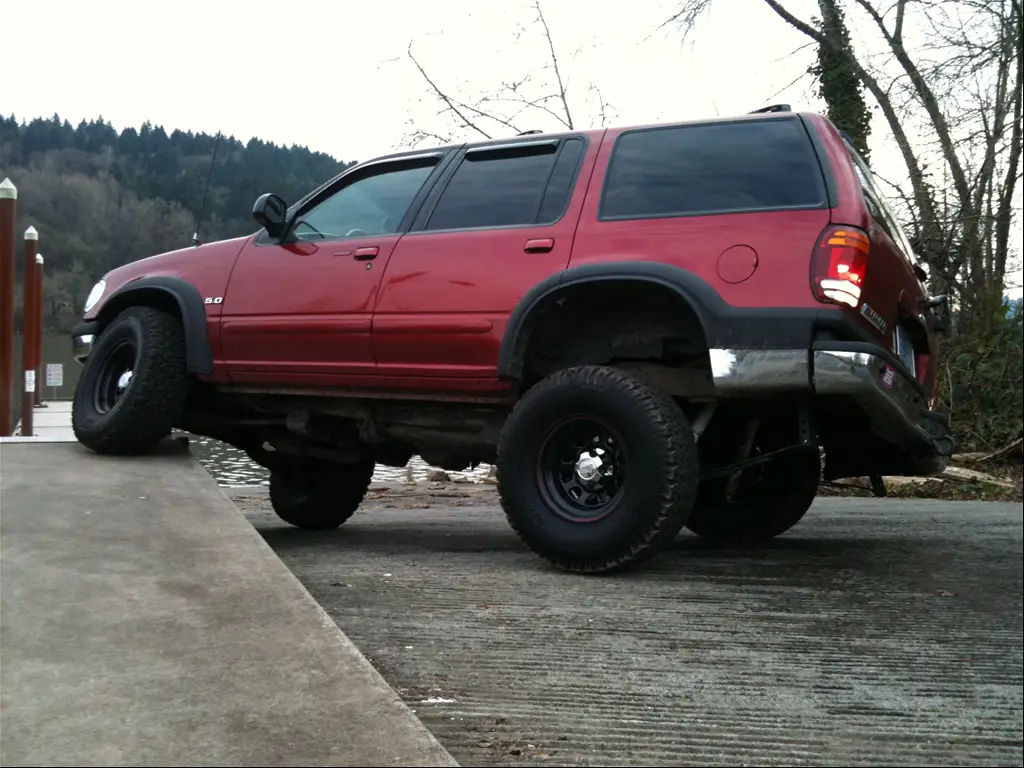

I painted the gold trim black, got a hitch, and installed a 95-98 steel front bumper. These are a bunch of random photo's taken in the last few weeks from some wheelin/shooting trips...
Testing out the new hidden hitch...
Me and the rig...
black trim black wheels, looks great
Yeah a 33" should still fit under it but I can't say for sure because I don't have one. The wheeling pictures were taken at Goat mountain near estacada
