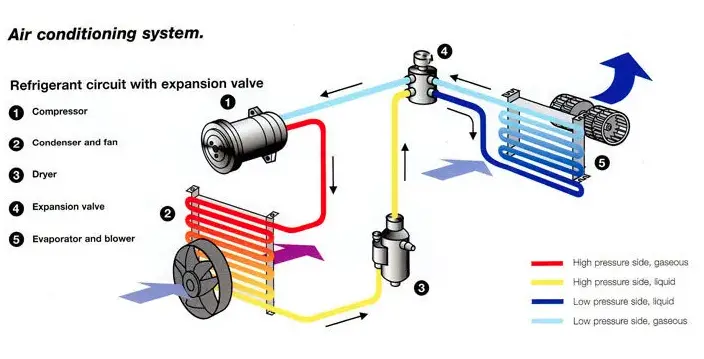

You can't seem to grasp the fact that your compressor only processes freon in your a/c system, which results in making the evaporator inside the pax compartment and behind your dash extremely COLD. That is the only thing it does..make that evaporator COLD. You also have a heater core under your dash. It is heated by the coolant in your engine/radiator system. The heater core gets warm to HOT. That is the only thing it does..make that heater core HOT!

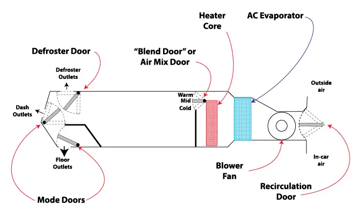

This is where the blend doors come in! These blend doors do exactly that...blend the COLD and HOT air available FROM the COLD evaporator or the HOT heater core until it matches the temp you as the driver select. it can be 100% all COLD or 100% all HOT or anything in between! In addition they direct this air flow into the different vents in your Explorer...dash/floor/windshield defrost/etc.
Your Explorer has DUAL air! You can select different temps for driver and pax sides. You have left and right side blend doors! They are independently controlled by these blend door motors! These motors are controlled by the on board computer! There are many inputs (to many to list here), but their position can pull air flow from the COLD evaporator chamber OR the HOT heater core chamber INDEPENDENTLY to the left and right vents AND in A variable mix (Both COLD/HOT). THIS IS THE ONLY WAY THE TEMP CAN VARY FROM ONE SIDE TO THE OTHER)!

picS below: How the compressor does it one and only job...make the evaporator COLD
and simple generic blend door system air flow (yours is way more complicated).
