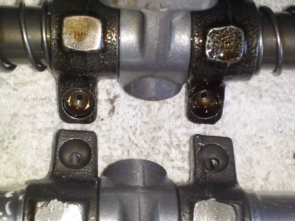

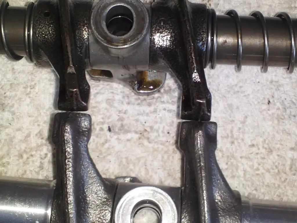

And I would interested in seeing the difference between the sealed power and Delta rockers.
No problems with the seals
ox;(
delta crap and these are new,low miles
old delta and new sealed power,much larger and oil holes are bigger too

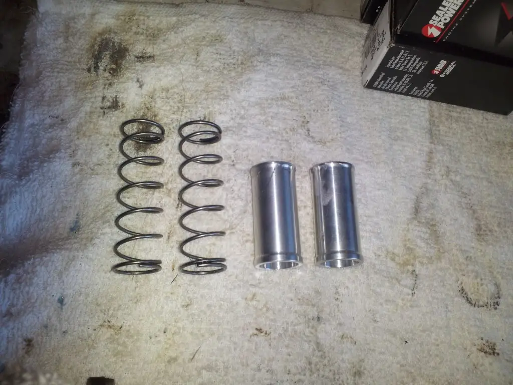

old and new rockers with spacers(thanks again to don)

That is a pretty big difference...thanks for the info....Delta is definitely out when it come to the rockers. What is the difference between having the spacers vs the springs between the rockers?
Yep,ive also had one explode on me!!the spacers are not available for sale to the public,they are free floating.the springs cause resistance witch means it causes hp loss;)
