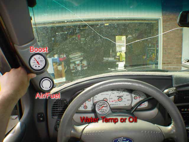

Alright I finally got everything hooked up. All works fine. I have taken some pictures, and am working on a write up. If you got any questions prior to the completion of the write up let me know.

You should switch the Boost and the Water Temp gauges. IMO it would be better to have the boost right there next to the RPMs.

Well I have had my gauges in for a while. I am not to ssure whether or not I am happy with my A/F gauge. I am going to get rid of it and install an oil temp gauge instead. It is an auto meter lunar series modified A/F gauge you can check the specs. Here if any one is interested.<url>www.gadgetseller.com<url/>

It sure does! Here is mine. It turned out great but i might get rid of it and use the "steering column gauge pod"
