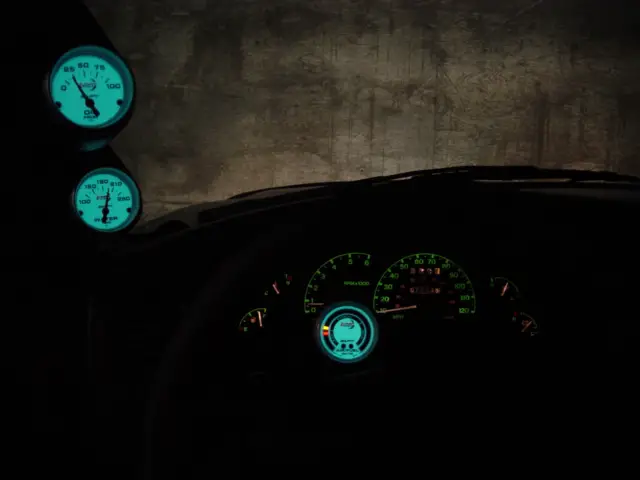

found it... it's a red wire with black stripe.... I took the front panel off (radio and climate control) and looked closely at the wiring... and found the right wire.... now my gauges light-up properly but still don't do nothing else except look good... still need to know which adapters to buy to splice into the tranny line to the cooler and adapter for the oil pan.... sh** I should of thoght about it at the beginning.... really... I though that gauges come complete.... but they look good. Pix comming soon... as soon as I can find a moment tomorrow to take them. I have used some fancy little bolts to attach pod to the pillar.... and cut pilalr open to run the wires.... now it looks like it came this way from the factory especially with gauges green backlight.

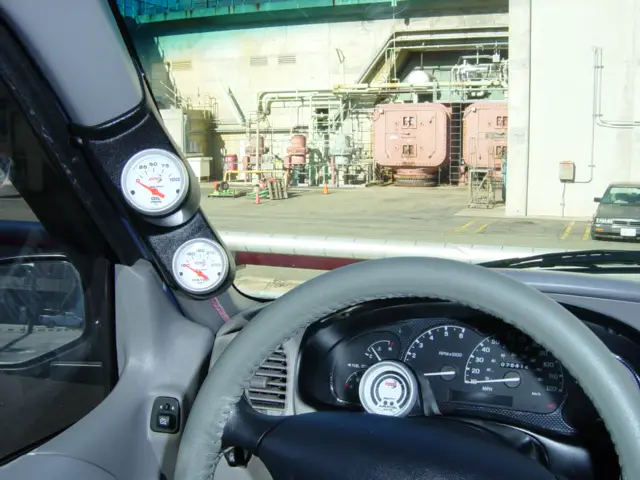

Here are mine.
May as well post some pics of my pod. Now that we know the F-150 steering column pod fits, I'm getting one.
