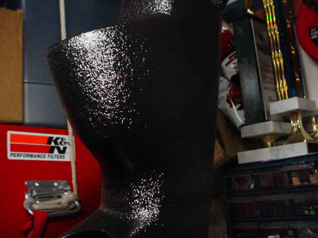

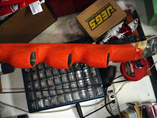

I went out this morning at like 4:30 and sanded all the Glazing Putty smooth with 180 & hit it with some grey primer. I will have more pics later, I am at work now. But I will sand with 220 tonight and primer once again, and then sand once more and then I have Wrinkle Paint to match the factory interior until I get to do the carbon fiber wrap. Stay tuned later tonight for more pics. I expect to finish toningt.
Looks like they've always been there... ;)
Damn, that does look good.
I must say that looks damn good, very professional looking. Can't wait to see it all done and installed in the X.
