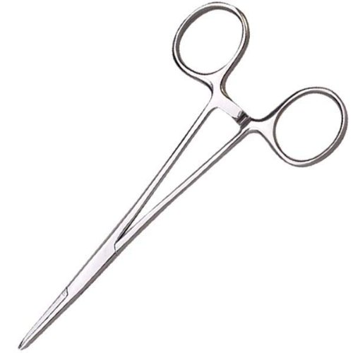

The pin will stay in the trans when you pull the vac mod, you need a pair of forceps to pull it out.

I can probably borrow a roach clip from my next door neighbor to pull out the pin. :p
