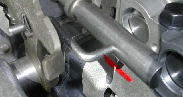

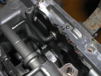

Before I would assume that... I would check all my linkages. and if ok externally drop the pan and check the Z link. In the A4ld most shifting is controlled by moving the manual valve.... sounds like your is not moving. Find out why not or if it is, first.
(Photos from Glacier991's Photo Gallery)
Thanks for the idea. I know that my external linkage is fine. As I run thru the gears I know that the manual valve is binding. I freed it up but still no movement. Should I replace this valve next and if i need to what else will I need to replace at this time? Thnks for all your help.
