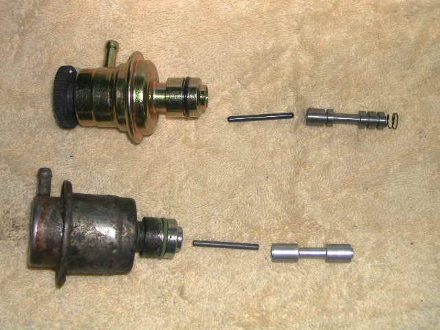

Here is a picture from Glacier991's photo gallery:
My old modulator looks like the one on the bottom of picture, but the new one ( FRAM ) looks like the top one in the picture minus the adjusting knob.( mine just has a screw no knob ) I have a question....Should there be a spring in there ? The bottom of the picture shows no spring. That is exactly what mine looks like, no spring. I was very very careful when removing so not to loose anything. Modulator, rod, & the part that goes into the bore....No spring. Does it need one ? is so what happened to mine ?

Some shift kits come with different hardware. The length of the rod, spool and spring are different from one to another. Keep the parts consistent. Not every kit has a spring. Glacier991 would have more information on the specific hardware in each brand of shift kit.
