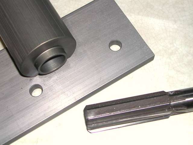

The tool itself is a flat metal piece that bolts to the pan rail. Mounted on it is a housing to guide the 7/8's inch reamer....
As you can see the end of the tool has a guide to make your you are concentric to the case bore (this is a well designed shop made tool jig!)
