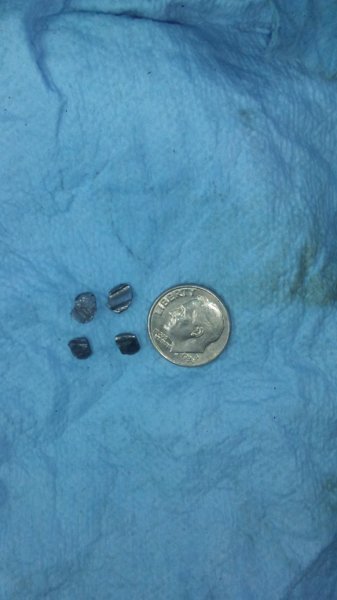

I bought the truck knowing it had tranny tranny issues off a old man said it was driving and just came to a stop one its to nice a truck to junk only 88k I checked fluid seemed pretty clean wouldn't move any gear pulled cooler line and had enough pressure shot about 5ft away so pump seems fine so I dropped the pan had normal friction material so I pulled the valve body on top of it was a few metal chunks size of a 1/4 of a dime I can't seem to see anything wrong with clutch bands was wondering if anybody had any ideas what I've got ahead I ordered a rebuilt valve body any other advice
It sounds like something is broken inside the transmission, before wasting your money on a valve body you should just pull the transmission out and take it apart to find out what happend. I could be a failed sprag or a broken shaft, you may not need a valve body.
if there are chunks of metal above the VB then do not install a new VB expecting it to work
Something broke
Welcome to this forum! I'm sure that there are more metal fragments in the transmission. It will clog a replacement valve body. The older version of the A4LD wasn't as tough as the later versions since they upgraded certain hard parts.
Here's a pic of what I found on the
Here's a pic of what I found above the valve body idk if its the sprag or the shaft just getting some info before I pull so I know what hard parts ill need to replace
