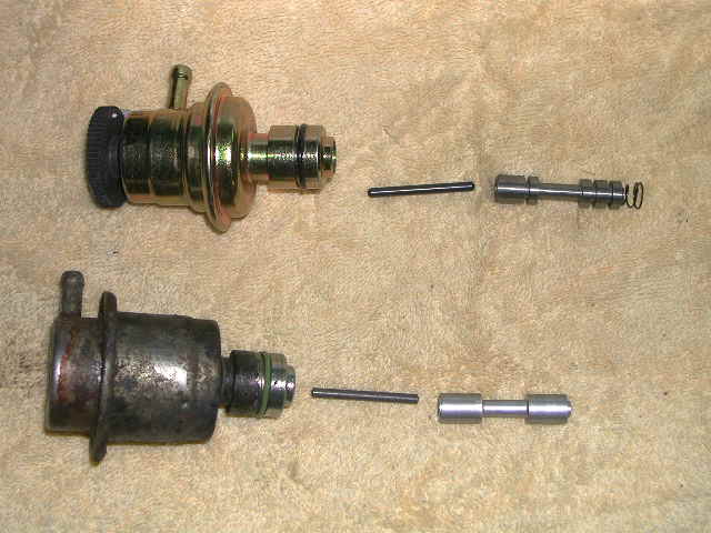

Ok I have a 94 Ranger 4X4 with the 4.0 six and the A4LD tranny. The transmission has had a problem with 1 to 2 and the 2 to 3 shifts. To get it to shift from 1 to 2 and 3 I would almost have to drive it like a manual and rev up to 3 to 4 grand and lift the throttle. The 3 to 4 or 4 to 3 shifts worked just fine. None of the gears felt like they slipped and I have been driving around this problem for almost 2 years.
After researching this problem (on this fine site) and finding fluid leaking out of modulator I decided to replace the modulator. I purchased the modulator and was going to put it on myself but needed some other work done and had my mechanic friend replace it. This was a bad idea as when he replaced the modulator he didn't put the pin back in. When I picked up the truck the transmission felt like it was slipping badly and was un-driveable. I determined that it was actually starting out in 3rd gear and once I got it up to speed worked fine between 3 and 4.
So I got a replacement modulator pin, pulled the modulator and put the pin back. This did not solve the problem and in fact behaved the same with or without the pin. I then pulled the modulator and verified that it was working with a vacuum pump. I have observed that the hole that the modulator pin goes in has no give and in fact when I put the modulator in it pops out a bit as the pin is compressing the diagram in the modulator. Is this normal??
This is all very frustrating as I could at least drive the truck before all this started. After reading these forums I think something is hung up in the valve body but am not sure hence my post.
Any and all help would be appreciated!
