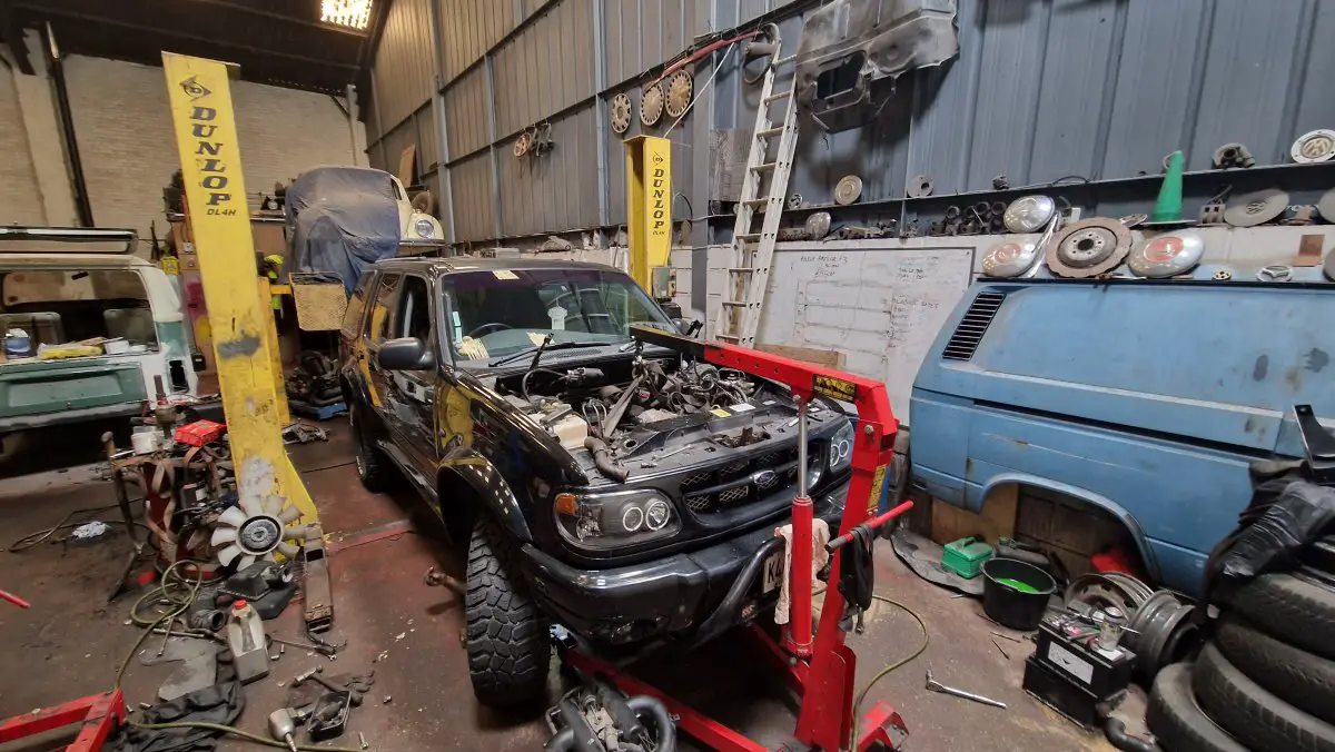

love all the vw's!!!
The VWs belong to the guy doing my chains and swapping my engines over.

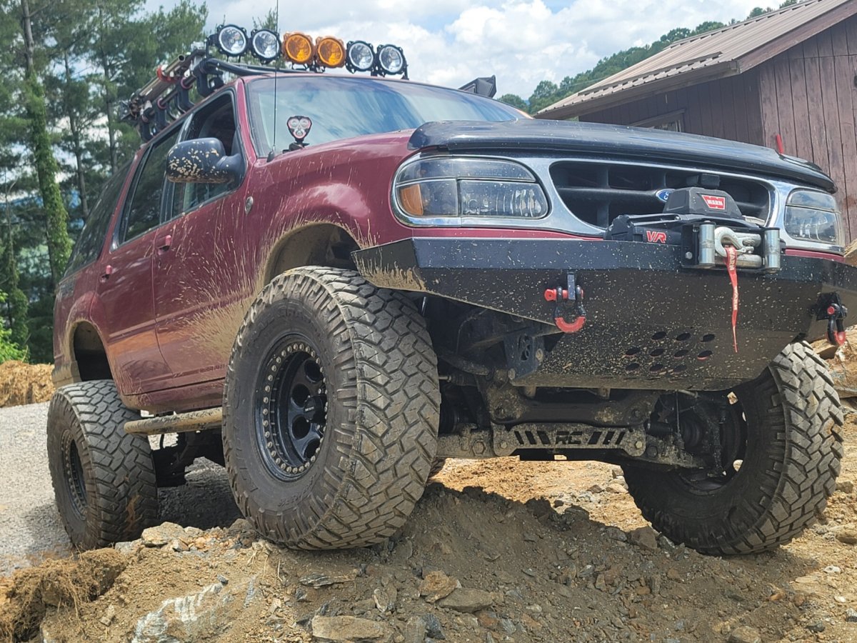

You can see the install in this playtime pic. :)
I'm like a Jeeple...
-Dan
