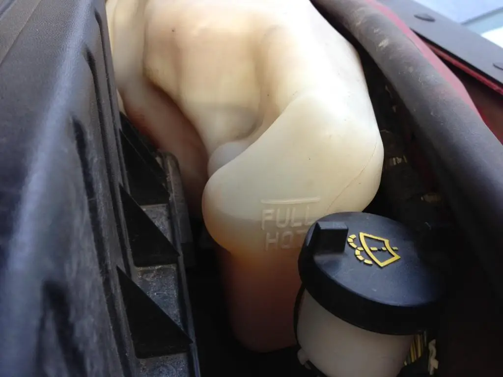

check your coolant level
pb3 -
Here is the coolant level. Engine was hot when I took this picture.
