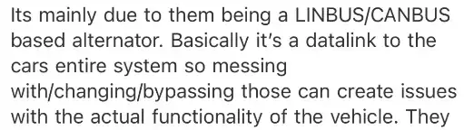

This was what a member received from a company rep regarding why only Ford alternators should be used.

It has been mentioned several times that the 5th Explorer's alternator should only be replaced with an OEM unit. Many members using aftermarket ones have had issues. There was also an article explaining why to use OEM only, but I am unable to find it.
