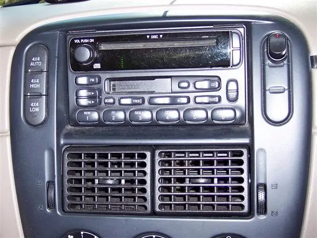

I don't have the message center so I put my switch here:
