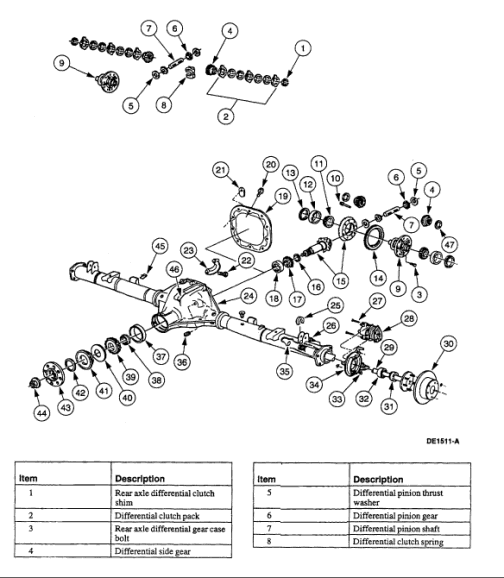

so, i read my chiltons manual and it says there is either a plug on the diff cover or a plug somewhere else on the diff. so there is no plug on the diff. i take it off to drain it and im looking around for a plug and im not seeing it. there is a bolt towards the top of the diff but i dont think it is the fill hold, it looks like it is holding a magnet on int the diff, i need help. its a 97 3.73 open
There is a 3/8 square drive plug on the front upper part of the case.
The fill hole ( on my '99 ) is not on the cover, it is located on the drivers side upper part of the axel housing.
You can see it on the attached picture; item # 36

#36?
thank you much, ill be back when im done (hopefully) to give a report
