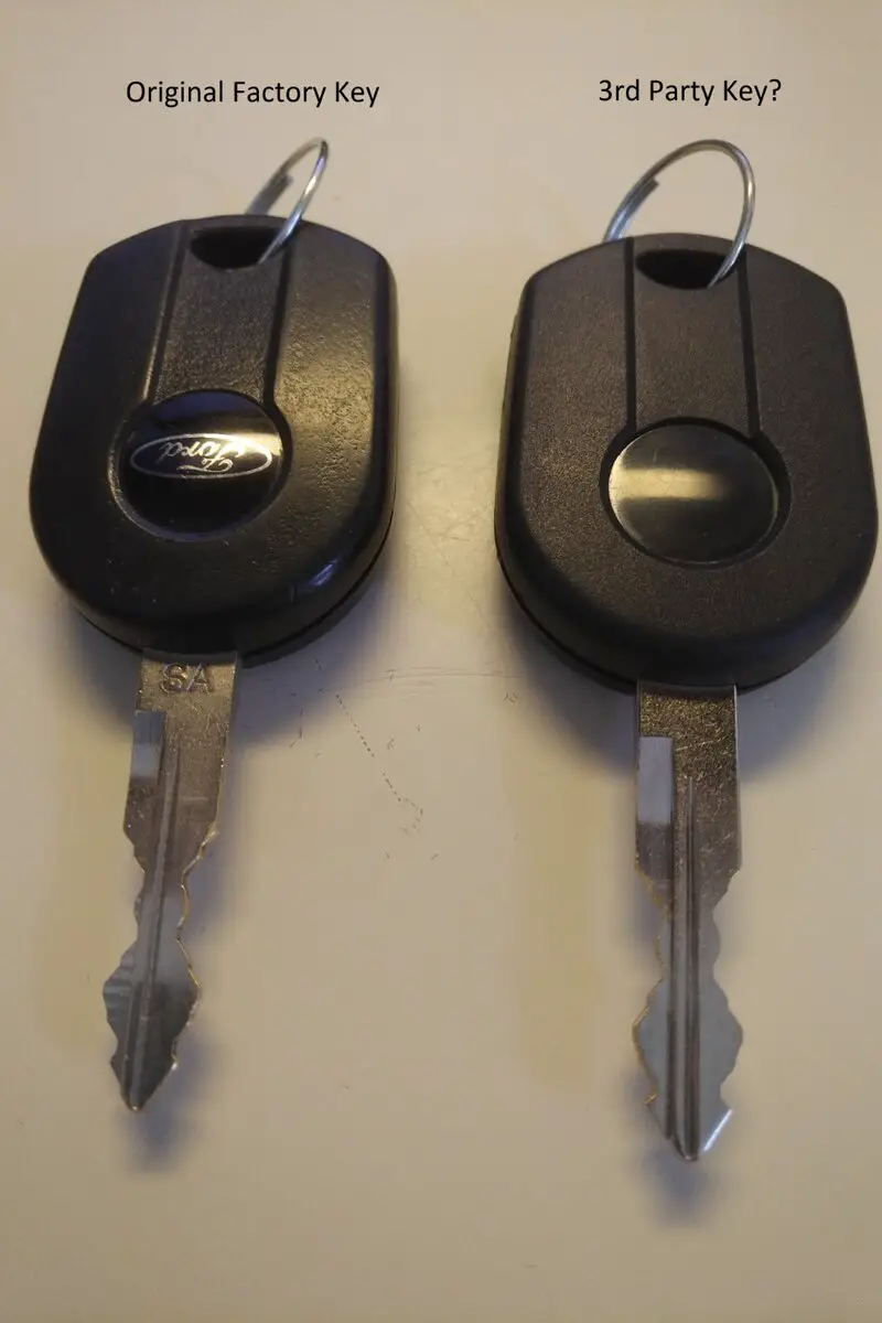

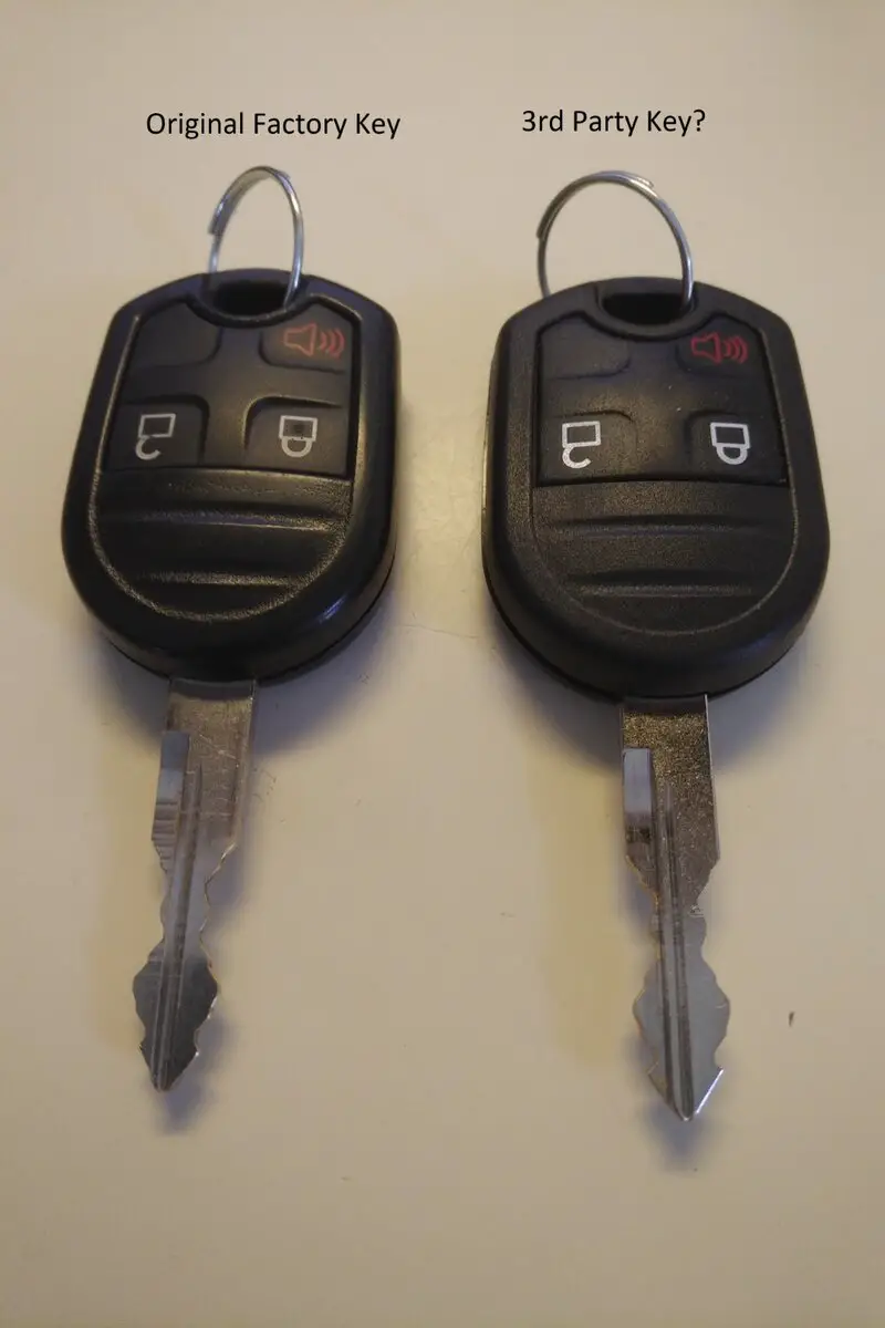

I also saw a MPC Remote Start Kit for 150 bucks, but it requires 2 factory keys in order to activate. I'm not sure, but I got 2 keys from the dealer, one key looks original ford with lock, unlock & horn button with a ford logo on the back. The 2nd key doesn't have a ford logo on the back. When I opened them, the insides were a little different as well. So I don't know if the 2nd key is factory original. The cases are almost identical.

Is This: BB5Z-19G364-A possibly the best way to go? Looks like all original ford. Cost, same as 3rd party.
