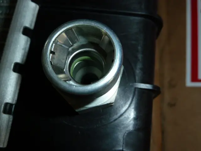

4 years ago, our EB Explorer 4.0 started leaking at the upper tank crimp, I decided to go with a Spectre Premium replacement after reading positive reviews. last week there were puddles under the car and found the 4 year old radiator leaking at the lower tank crimp. Oh well, buy another Spectre and be done with it. Next day after installing the new radiator there's puddles under the car, coolant and transmission fluid dripping. The old Spectre radiator had double O rings on the transmission coolant line fittings but the new one only has a single O ring that just leak. In addition, coolant is leaking all along the upper tank crimp.
Luckily, Amazon refunded my money and after researching on line most agreed just go with a Motorcraft radiator for the better quality AND double O ring cooler line fittings.
RockAuto had one in stock so I decided to pay more and fix my leaky radiator for good, it arrives today and what do I find? The American made Ford replacement radiator only has one O ring cooler line fittings, fingers are crossed it doesn't leak:crazy:
I replaced the Spectra fittings with these. They have double o-rings. They might fit the Ford radiator. Also, I would recommend trying a 16 psi radiator cap instead of the OEM 20 psi cap. I have been running 16 psi for a while with no issues. The lower pressure puts a lot less stress on the cooling system. On the odd chance you see a problem than just reinstall the OEM cap you took off.

You could un-screw the old double O-ring trans fitting and use them instead of the single O-ring one's in the new radiator.

The Dorman fittings have a different size thread than the Dorman fittings, ask me how I know;)

Just an update, I installed the Motorcraft radiator along with the 16psi cap and so far no leaks from the tanks or the single O ring transmission cooler line fittings:thumbsup:
