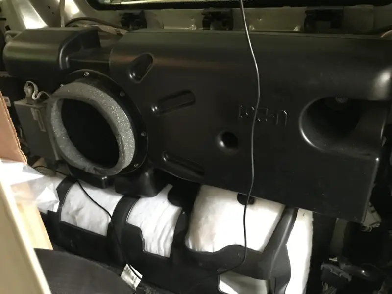

While installing the camera wires and head unit I got distracted:
That box actually looks fairly big. I’m sure with a small cu.ft sub and decent power it could sound pretty good.
