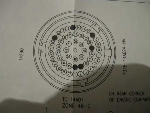

I took this pic out of my 94 Explorer Truck Wiring Diagrams, which was a Ford publication. I assume it's accurate, but I can't vouch for it, as I did not get out there and compare every wire on my '94 with this chart. I'll post the pic, then I'll post what each numbered wire is according to the manual.
BWP (Big White Plug) pinouts - Referring to the 1994 Explorer wiring guide *picture* above.
(sorry for the formatting, can't figure out how to make columns)
Wire# Color Circuit
1 Red-White Temp Gauge to Temp Sending unit
2 Yellow-White Fuel Gauge to Fuel Gauge sender
3 White-Lt Blue Front Right Turn signal
4 Tan-Lt Green Anti Theft System switch feed
5 Lt Green-White Front Left Turn signal
6 Red Windshield Wiper Switch to Windshield Wiper motor
7 Purple-Orange Fused Run Only feed
8 Lt green Stoplamp switch to stoplamps
9 Dk Green-Lt Grn Shift on the fly 4x4
10 Pink-Lt Green EEC Module to Check Engine Lamp
11 not used
12 Tan-Yellow Ignition Coil negative terminal
13 Tan-Lt green Brake fluid switch to reservoir module
14 Gray-Red sensor signal return
15 not used
16 Black-White washer pump motor feed
17 purple-white dual brake switch indicator lamp
18 lt blue-orange O2 sensor feed - running only
19 not used
20 black-pink Windshield wiper switch to windshield wiper motor
21 dk blue-orange Windshield wiper switch to windshield wiper motor
22 white windshiled wiper switch to windshield wiper motor
23 tan-orange fog lamp switch to fog lamp
24 lt blue-black fog lamp switch to fog lamp relay
25 dark green failure warning light
26 lt blue-pink ABS control module feed
27 lt gray-orange Battery saver lamp feed
28 not used
29 not used
30 pink crank enable relay
31 white-red oil pressure indicator to oil press sending unit
32 light pink oil level relay to oil level sensor
33 not used
34 red-white electric t-case to manual level position sensor
35 lt green-black headlight dimmer switch to high beams
36 gray-white daytime running lamp
37 red-black headlight dimmer switch to low beams
38 lt blue-black brake feed
39 lt green-red igition switch "accessory" to alternator regulator "ign" terminal
40 lt blue-yellow manual level position sensor to EEC module
41 dk blue horn switch control
42 black-pink backup lamp
43 dk blue-yellow thermometer sensor feed
44 lt blue-orange ambient temp sensor to dash
45 orange battery feed to relay controller
46 brown headlamp switch to taillamps and side marker lamps
47 yellow-lt blue horn switch feed
48 black-white circuit breaker to seat latch relay
49 gray-lt blue htd backlite switch to time delay switch relay
50 yellow battery to load
51 brown switch feed
52 dk green power seat power feed
53 red-lt green ign sw to ign coil "batt" terminal

For anyone that does a search and finds this thread I figured out the problem (at least for me). In Pin 52 there is a dark green wire that feeds power seats. This needs to be a ground. If you put in a wire with a pin and ground it out in the engine bay... problem solved. I have a 90 BII and I had a 92 Ranger donor.
I'm in the process of a 4.0 swap with a 85'B2 and a 92' explorer. Any electrical assistance would be greatly appreciated.
your 92 BWP is different then the 94 BWP pictured above, as I said in your other post you should start your own thread for your conversion, this way all the info needed will be in one place!
