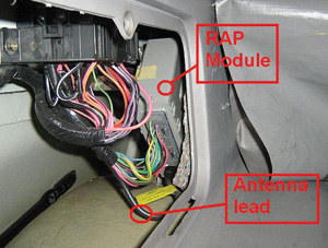

Are you sure you do not have a raps module? I believe They moved them in the late 90s to a location under the dash.
Hi cwol97401 , I'm not sure that I have seen that under the dash , but I will check it out :-)
Thank you

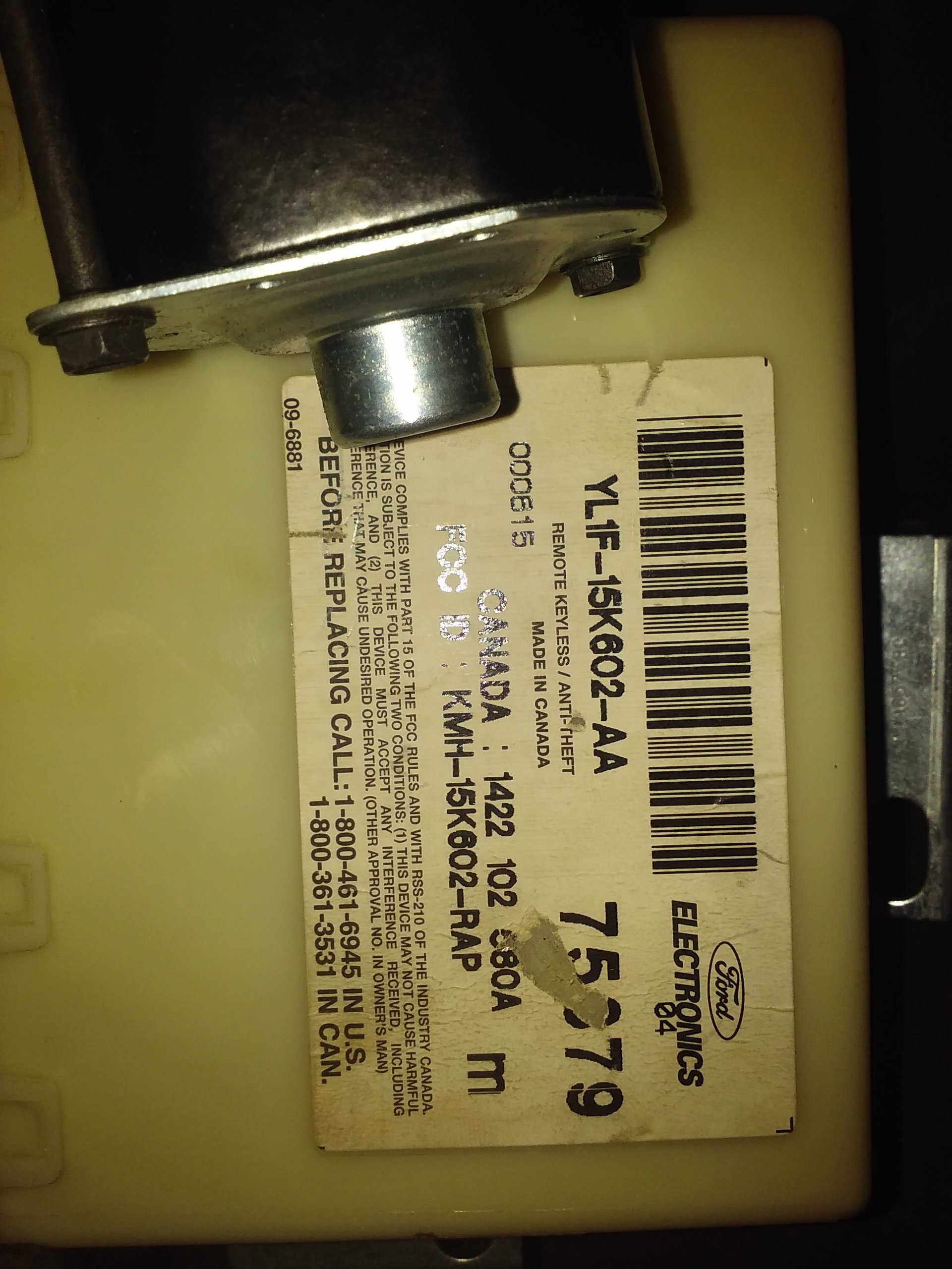

RAP module in my '97 EB is in the cargo compartment on the driver's side. Open the access panel on the side and look forward, you will see a box with relays in it - the RAP module also goes there. Most likely wiring is there - you may just have to get a used module and plug it in. Good luck.
To my knowledge, they changed the location for the 99MY
For those with a 2001 Sport Trac like me that didn't have the keyless entry module in the dash behind the passengers air bag, I found mine in the middle of the rear wall in the area above the jack....I used my borescope camera to search for it....got my code and it actually still works...hope this helps someone.

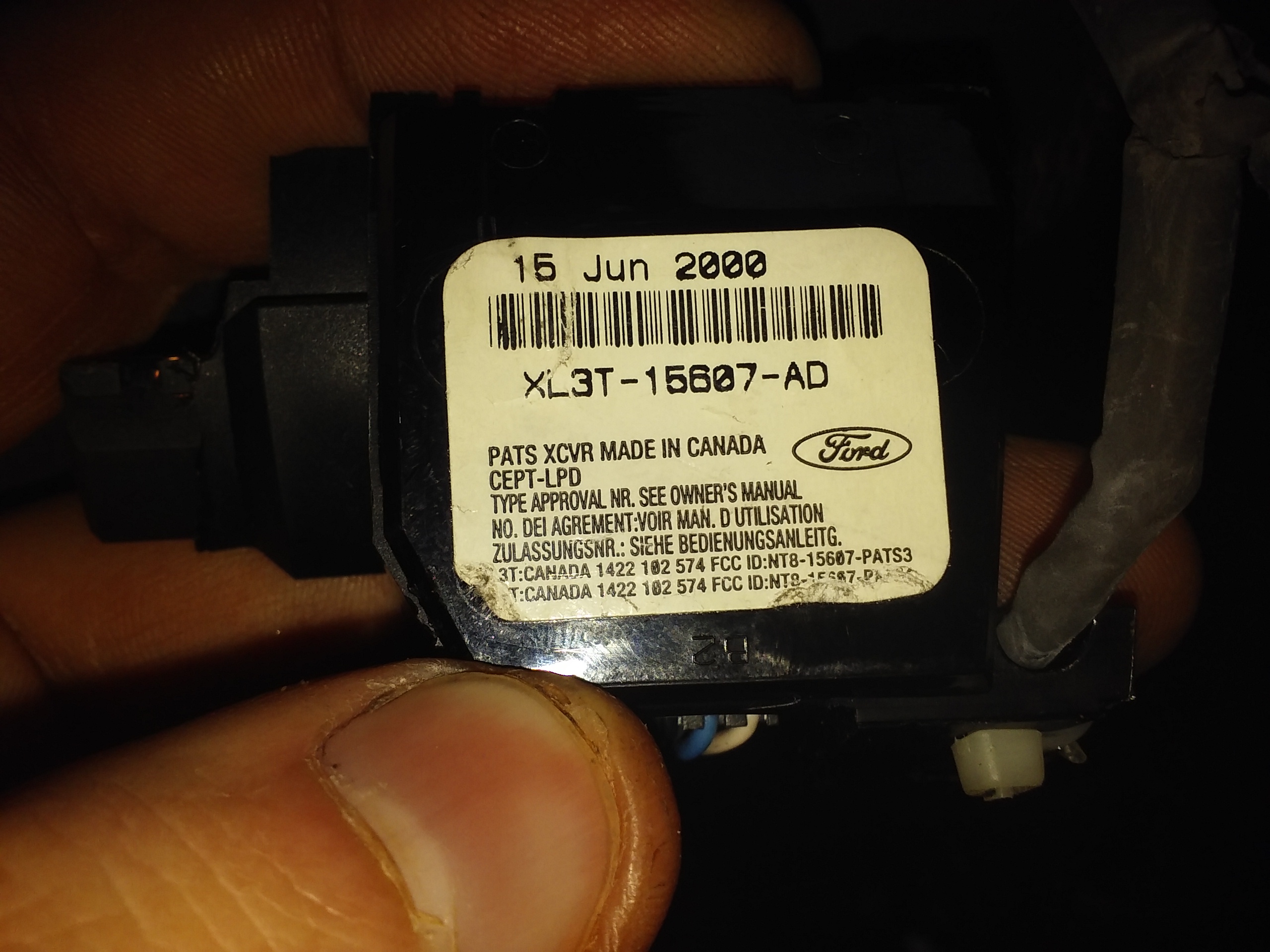

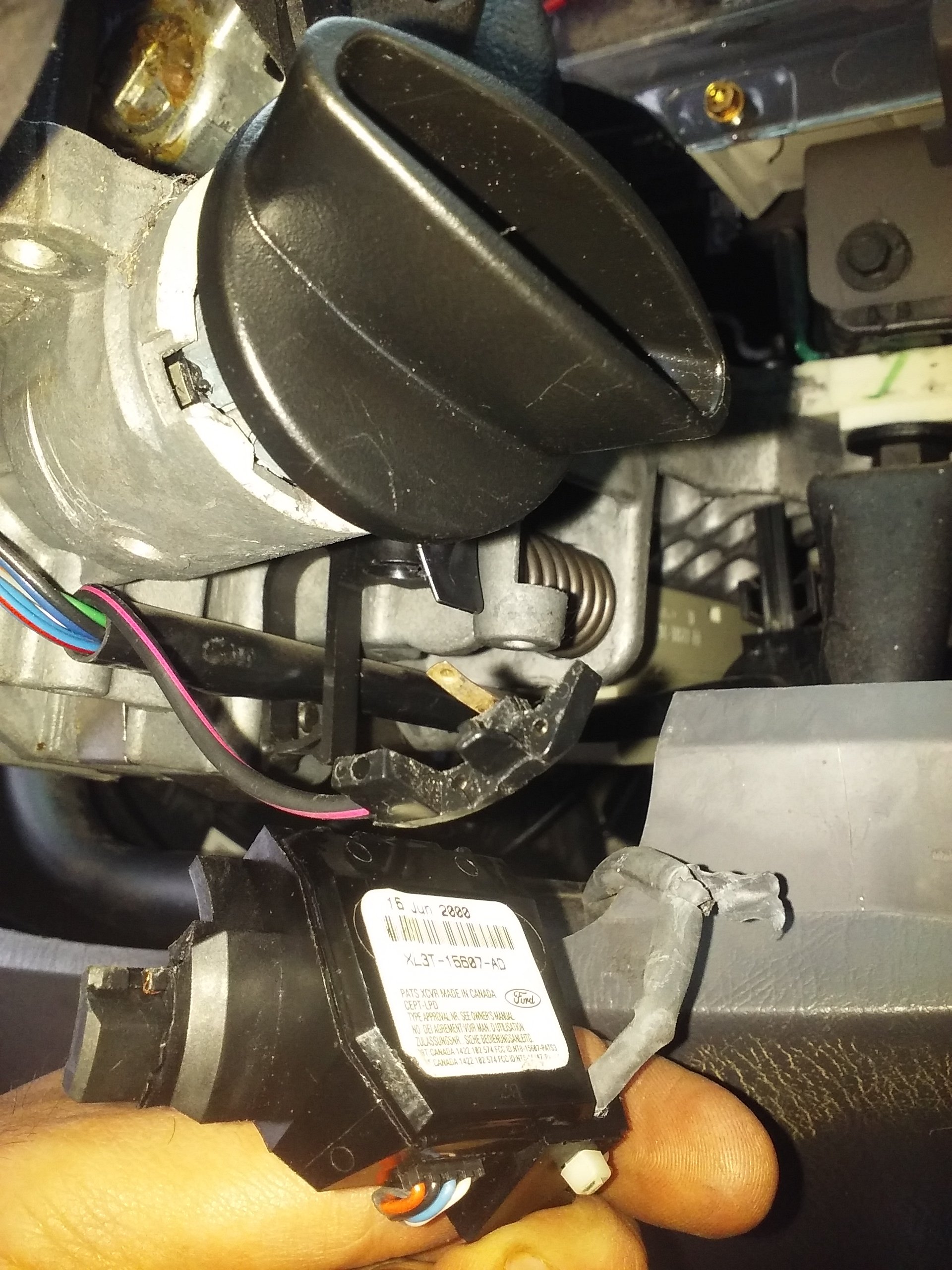

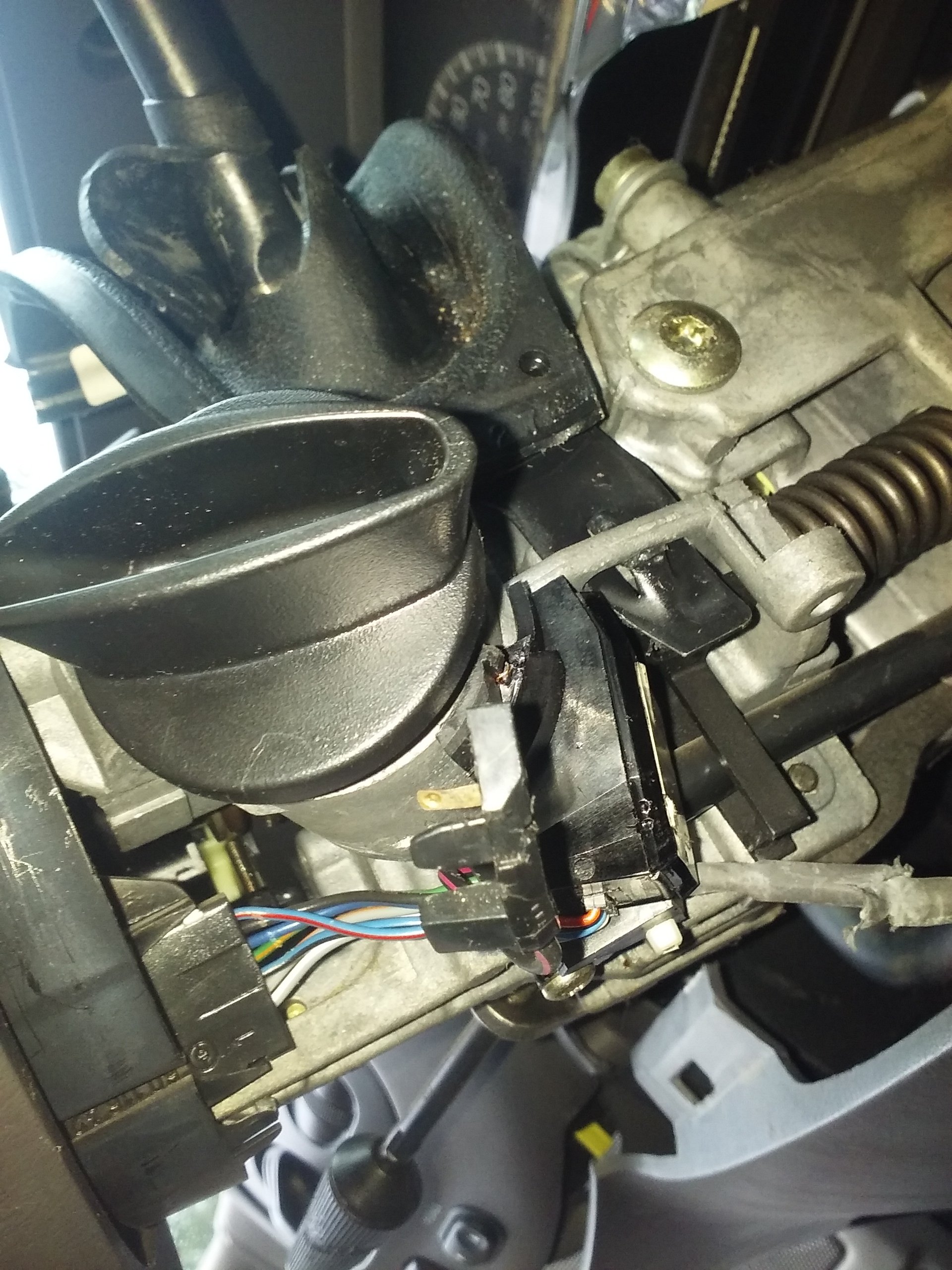

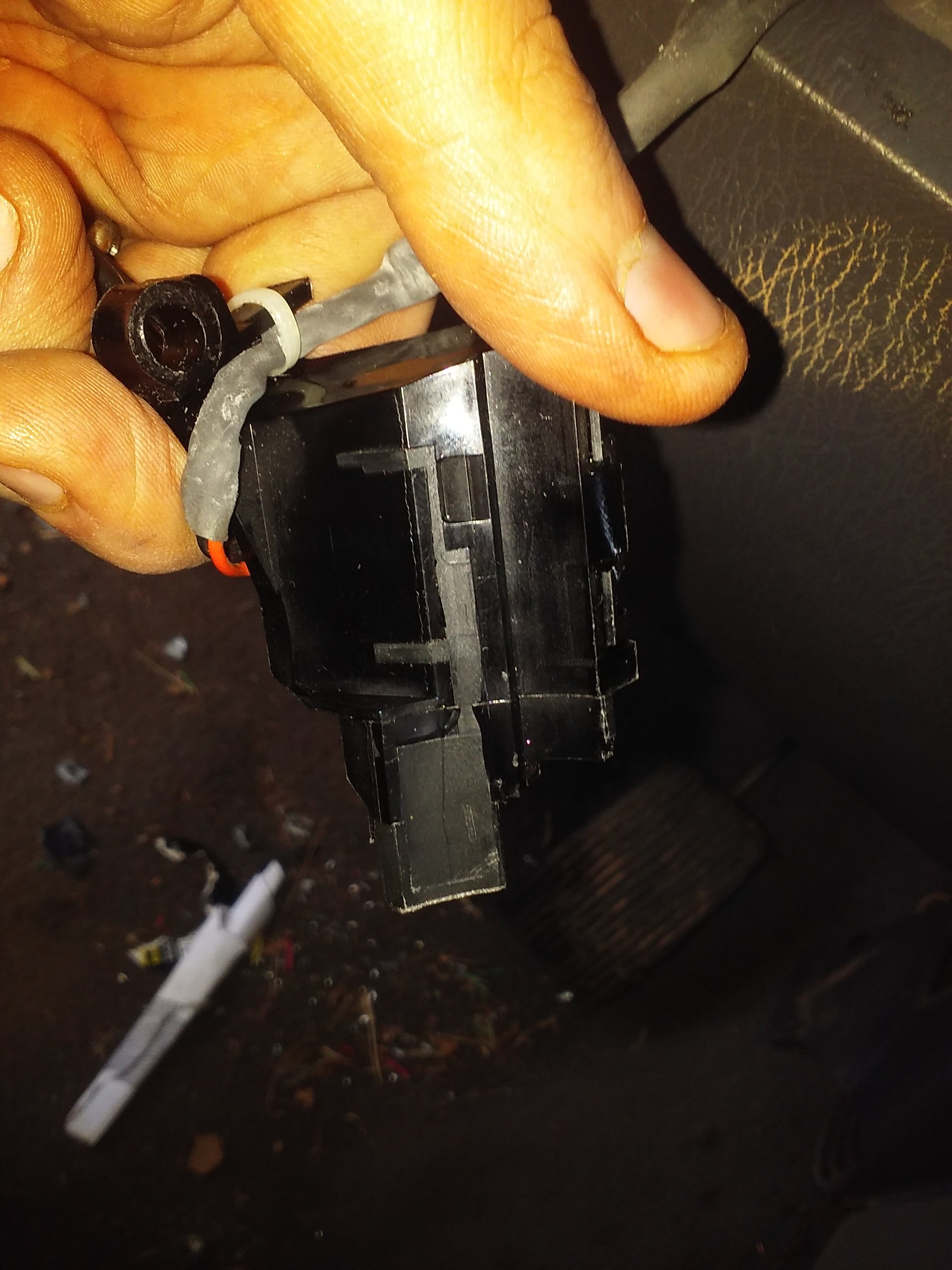

hello Im knew here and i may post these in wrong place if i did im sorry , My friend has a 2000 ford expedition,
hes gf throw away the real keys and he had no way to recover them, Doing so he had the Ignition switch replaced she also broke the antenna around the key tumbler I'll show pics of it .
Well after getting the Ignition switch replaced at a local shop it would crank in die immediately they told him it was hes feel pump so he brought it over dropped it off at my house and we drop tank in changed it then i we found out did same thing once replaced with new part from autozone, then i asked him some Questions that when he told me about Gf throwing hes keys out and there for he had Ignition switch replaced . so what im asking how im i able to Bypass to get it to crank in stay cranked? does key need to be reprogrammed dealer? are is the antenna around the key tumbler no good need replace it and then try program i did the 15 min cut off till theft light stop blinking did that 3 times and then try start still same thing. I found the pat module theft thingy here are pics of what i have and the key and ignition switch and key is after market,,,, Any ideas are help is much appreciated god bless
@antty09 This is an Explorer/Mountaineer/Ranger Forum (not an Expedition forum) though I would assume many things related to security keys are similar.
If you have no original keys you'll need a locksmith or dealer to program new keys (it might be possible to do it yourself if you have something like ForScan, IDK). The PCM needs to be programmed to know the new key codes, Nothing else needs to be touched. There's nothing you can do to bypass the PATS system, which will not turn on the fuel injectors unless the key is recognized.
If you've damaged the transceiver ring (it's not an antenna), or it's wiring, from around the ignition lock cylinder, it will need to be replaced/repaired. It's what reads the chip located inside the key and then sends it to the PCM for verification.
