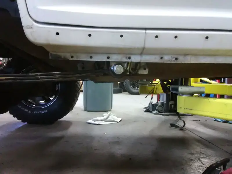

Making more room to stretch the legs!
Has anyone relocated their ECU into the engine bay? I removed my rocker panels and a portion of the front fender well. I'm now afraid of my tires/rocks destroying the wires going through the firewall. I'm not afraid to extend wires
Thanks yosty! I found that thread searching. My issue is where the wires enter the firewall. I try to avoid deep water if possible lol! Looks like I'm going to the junk yard to see if I can mount it like they do in the second gens.
