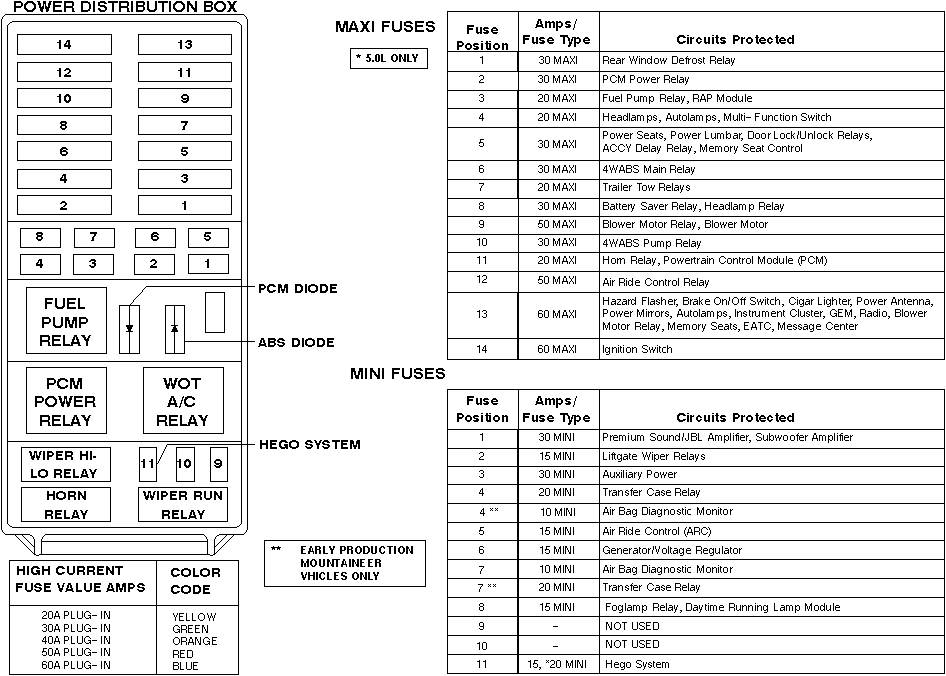

Wrong. ford has a fuse on the power feed side for the alternators internal voltage regulator.
1997 Ford Explorer indeed has a fuse for the alternator internal voltage regulator,
15 amp fuse under the hood mini fuse #6
IF this fuse is blown the alternator will not charge and the battery light will be on
Also if the bulb inside the instrument cluster is bad you will get a warning chime and the alternator will not charge
You can easily test if the alternator is charging, with the vehicle not running you should have 12.0-12.5 volts at the battery. With it running you should have 13.0-14.4 volts at the battery.
Have a look:

What I meant was Ford does not fuse the alternator output directly. Indeed, the regulator circuit is fused; thought the OP had mentioned checking that. At any rate, the batt. light was ON, so the fuse was good, no? And, you did not mention the Fuse Links at all, as though you can state positively they are OK.
