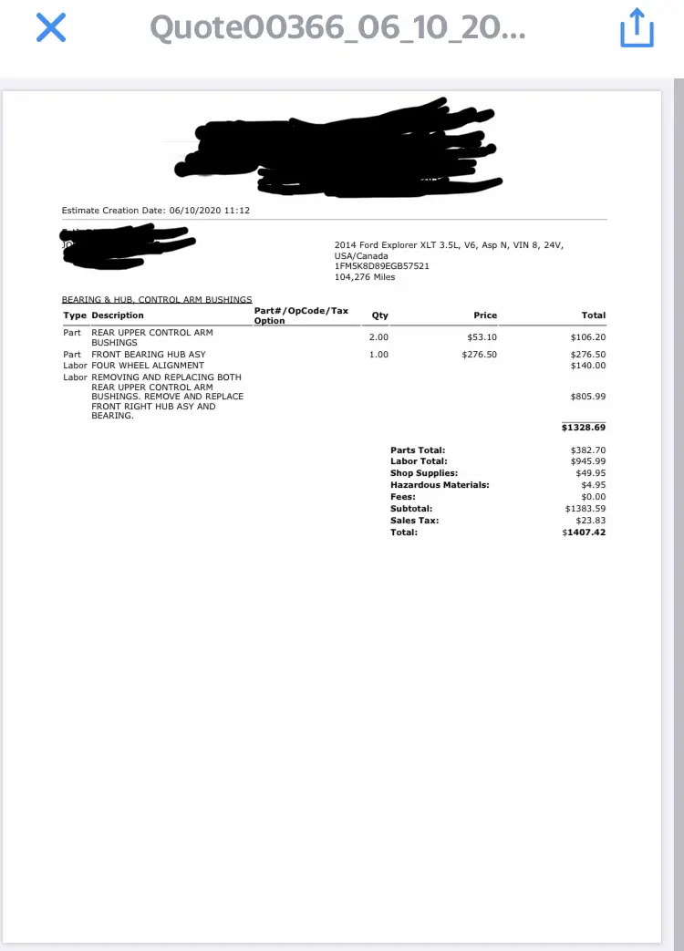

More details.....R wheel hub bearing assembly part #HB5Z-1104-C $276.50 and 2.5 hrs labor. Alignment $145. Rear upper control arm bushings both sides part $53.10 each and 3hrs labor. Total price $1414.95 minus mothers ford engineering discount $1376.
Dealership will not put into writing about wheel bearing upon asking. I think I might pay the $120 diagnostic fee and move on from this dealer. I told them to put everything on hold and do not touch my car

I took the car in for the humming noise coming from the front center of car that gets louder 40+ MPH. It almost feels like having a new set of brake pads that are rubbing slightly onto the rotor causing slight friction and drag. I never noticed abnormal noise coming from the rear of the car. definitely no clunking sounds.
When dealership called after inspecting the vehicle is when they told me I have some play in the rear bushings and they recommend replacing. Not sure why they were looking at the rear of the car when I complained about front noise.
The work order is very basic and was only emailed to me after requesting something in writing so I can see exactly what they are wanting to repair. I’ll see if I can attach it.
The reason why I decided to take the car to a dealership for further inspection was for a second opinion and I was mentally prepared for the cost of a transfer case/ptu. My first inspection was At my coworkers husbands garage. He used to work as a mechanic for roush. He test drove my car and stated right away that he’s 90% sure it’s a transfer case bearing. Then we put the car up on the lift and there was no play in the wheels. This is why I’m hesitant to believe the dealership when they say to trust their mechanic that I have a bad wheel bearing. If they are that confident I wish they would put it in writing. I would be extremely happy if it was only a wheel bearing and not a transfer case.
