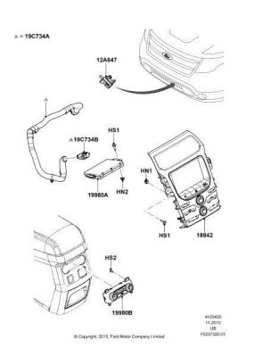

This is for the evap temp sensor but should be the same for the ambient:
Ambient Temperature Resistance
-40° C (-40° F) 832,519-1,017,523 ohms
-20° C (-4° F) 263,111-290,807 ohms
0° C (32° F) 91,058-100,644 ohms
20° C (68° F) 35,473-39,207 ohms
25° C (77° F) 28,500-31,500 ohms
40° C (104° F) 15,307-16,919 ohms
60° C (140° F) 7,171-7,925 ohms
100° C (212° F) 1,976-2,184 ohms
120° C (248° F) 1,131-1,251 ohms
