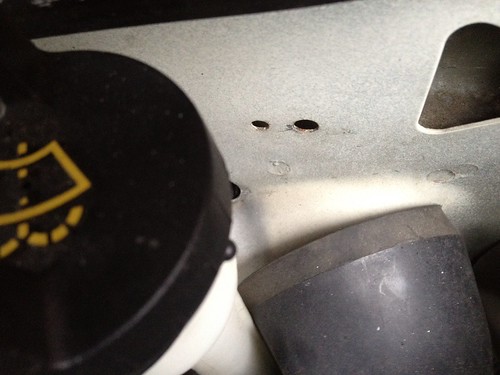

Having thought about this it made no sense that the sensor was in the engine compartment. See the locating holes for the sensor housing next to the windscreen washer bottle.
Having looked at the previous photographs posted by BigRondo, explaining where the sensor should be I removed the secondary black grill guard and found the locating holes. I passed the cable loom through the bulk head just behind this part here.
The wiring loom was just long enough to reach the new location.
Why the sensor was located where it was, who knows? Was it a manufacturing mistake or did someone move it?
It's fixed and it reads the correct external temperature, I am we'll pleased as it was really bugging me.
