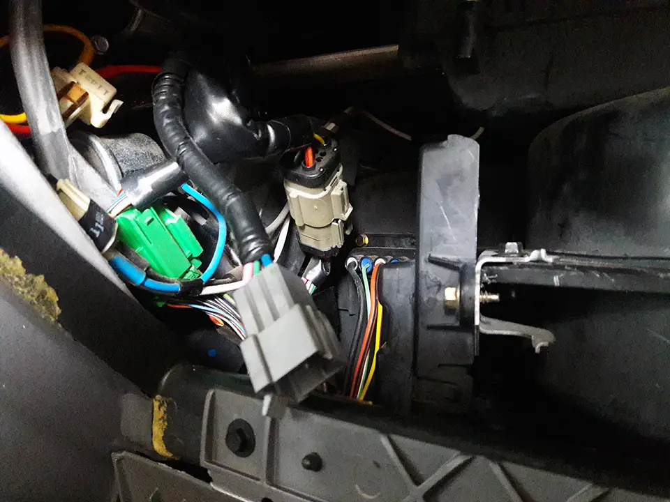

I also found this connector not connected to anything. Anyone know what it's supposed to be connected with?

The connector looks to be in the area where the trailer brake controller plugs into.
